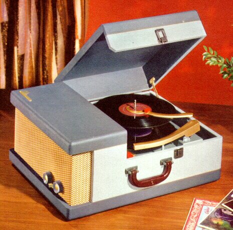

I have been lucky to pick up quite a few new record players over the past week or two, here is one of them, more to come!
Found this at a local antique store about 2 weeks ago. It is a 1956 VM 556A Tri-o-matic portable with some very cool features. The speaker grill is a brushed anodized aluminum and it has the very cool clam shell side opening lid.
It has the illuminated Lucite rod that when pushed actuates the REJ mechanism. What is also cool is it has the retracting idler wheel option, Siesta-matic I recall? The amp is BIG for a portable, it is a P/P dual 6V6GT with an optional amplifier input and an external speaker output . The coolest thing is the huge mesh screen window over the amplifier and speaker compartment! This is an audiophile's dream, you can watch the speaker thump and the tubes glow while you listed to records!
I recapped her, cleaned and re-lubed the changer and installed a new 81T cart I had sitting around. She sounds great and looks even better.

Congrats, your photos of your actual unit look just as clean as your brochure photo... glad it went to someone who will fix it up & not gut it to make a guitar amp! :lol:
