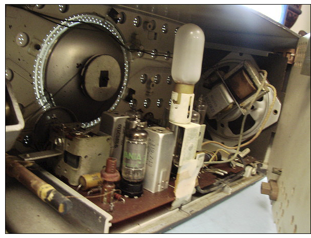

Hello All,
Thanks to the efforts of ARF members, I discovered the I.D. of my Grandparents kitchen table radio of years ago and had been looking for one since: viewtopic.php?f=1&t=156469 The early images have been lost or removed, so will add what I have back to this thread as it progresses...
Found this beauty recently on Ebay after 6+ years of searching and received it Monday---it is ivory instead of black/dark-brown like Grandparents' set, but just too nice (and rare) to pass by. Only needs a bit of cosmetic attention along with a good detail/cleaning... Electronically, the volume control needs a dose of DeOxit Faderlube and the tuning cap needs a good "fin-cleaning" as it's very scratchy/noisy. The filter caps also need replacing as there is a trace of hum in audio. Appears to have all original DuMont tubes. Remember wondering why Grandparents' set didn't have a dial-light with that neat slide-rule dial and found out when I pulled back off of mine tonight that they do---just the bulb is burned out ! Must not have lasted long... PCB seems very cheaply made and only has a couple caps and resistors along with a Couplate. The vinyl insulation on the dial-lamp socket leads is "decomposing" and there is an oily mess where it has dripped off... It was a perfect radio for use on the kitchen table as it has speakers in both ends---am wondering if this was a selling point for Nana & Grandpa Buddy ?
Has anyone else seen or had one of these radios ??? Can't find a single thing on-line about them... There was a pink version on Ebay around the time I began search and did save the pics...
Below are a few pics to get things started...

You guys wanna know who really made this radio?
I knew right away by looking at it.
This radio is actually a Sylvania!
 Post subject: Re: DuMont 1130 project...
PostPosted: Aug Fri 18, 2017 2:11 am
Posts: 5738
Location: Indianapolis, IN
Please elaborate, Joseph...
PostPosted: Aug Fri 18, 2017 2:24 am
Posts: 1476
Location: Earth
As some of you may know, I'm a big time plastic, post-war AA5 collector.
Those speaker grill designs were a dead giveaway.
Then the pictures of the insides verified it. The circuit board design and the cabinet.
See all those mysterious "holes" in the cabinet, only visible from the inside. Seems odd, right?
It's called repurposing ladies and gentlemen.
The original cabinet for the original manufacturer's design was designed to let -light- out via the holes.
In the 50s, Sylvania offered a clock radio and a straight table radio line with its night-time themed "Starlighter" series.
Here's what you do, do a Google image search for "sylvania tube radio 1202"..........

Just looked up the 1202---have never, ever seen that radio, but the basic cabinet is identical as is PCB...
Below is a pic cropped from SAMS...
I do like the DuMont front panel styling MUCH better, though ! (and I did wonder what the holes were for)

This set was sure designed to be easily assembled and serviced---remove the volume knob and one screw in center of radio bottom, desolder the audio output transformer primary wires from terminal posts on top of PCB and it easily slides out of cabinet ! The tuning dial mechanism is attached to cabinet front and a pin in pulley engages a slotted lever pressed onto tuning cap allowing easy separation. And the lever makes a good "knob" for tuning with chassis on bench !
Spent a couple hours tonight cleaning the PCB with Q-Tips---used 91 % Isopropyl alcohol to remove the mess caused by the dial-lamp wiring "ooze" drippage and water dampened on the 60 year dust accumulation. The dial-lamp socket can't be easily disassembled, so cleaned the wires multiple times with the alcohol---think after all this time, the vinyl should be fully "bled out"...
Haven't worked on an old TV for around 30 years, so had to dig out one of my cheater-cords to test radio from a storage bin in closet---glad I kept 'em !
Carefully cleaned between tuning cap "blades" with a piece of thin plastic wrapped with paper napkin. Was still noisy afterward, so disconnected ferrite-rod antenna and tried without success to find shorting areas with ohm-meter---they weren't making any contact whatsoever ! Then took a small strip of the thin plastic used for cleaning and gently slid between stator and rotor blade sections one by one with radio on and finally found area where they were nearly touching---with strip in place, tuning was fine across entire band. After blowing off PCB with compressed air, volume control even functioned normally. Radio performs well with excellent sensitivity & selectivity as most AA5's I've seen of that era do. The radio sounds good also and since the very slight hum is only noticed at minimum volume, am going to leave the dual-electrolytic can alone for now---will be very easy to replace at any time due to service "friendliness"...
Speaker assemblies are also removed easily by lifting the back cover mounting screw brackets upward like a latch and sliding them out.
