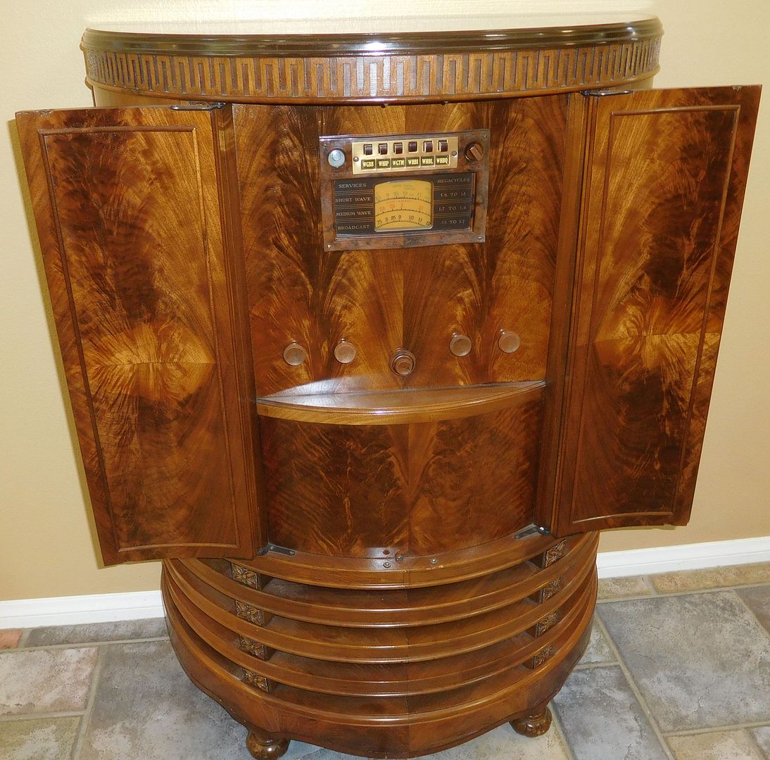

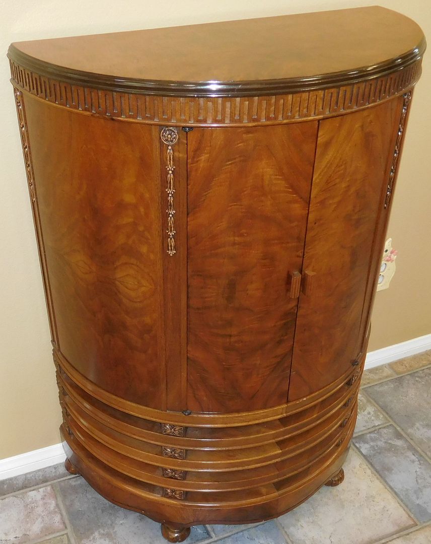

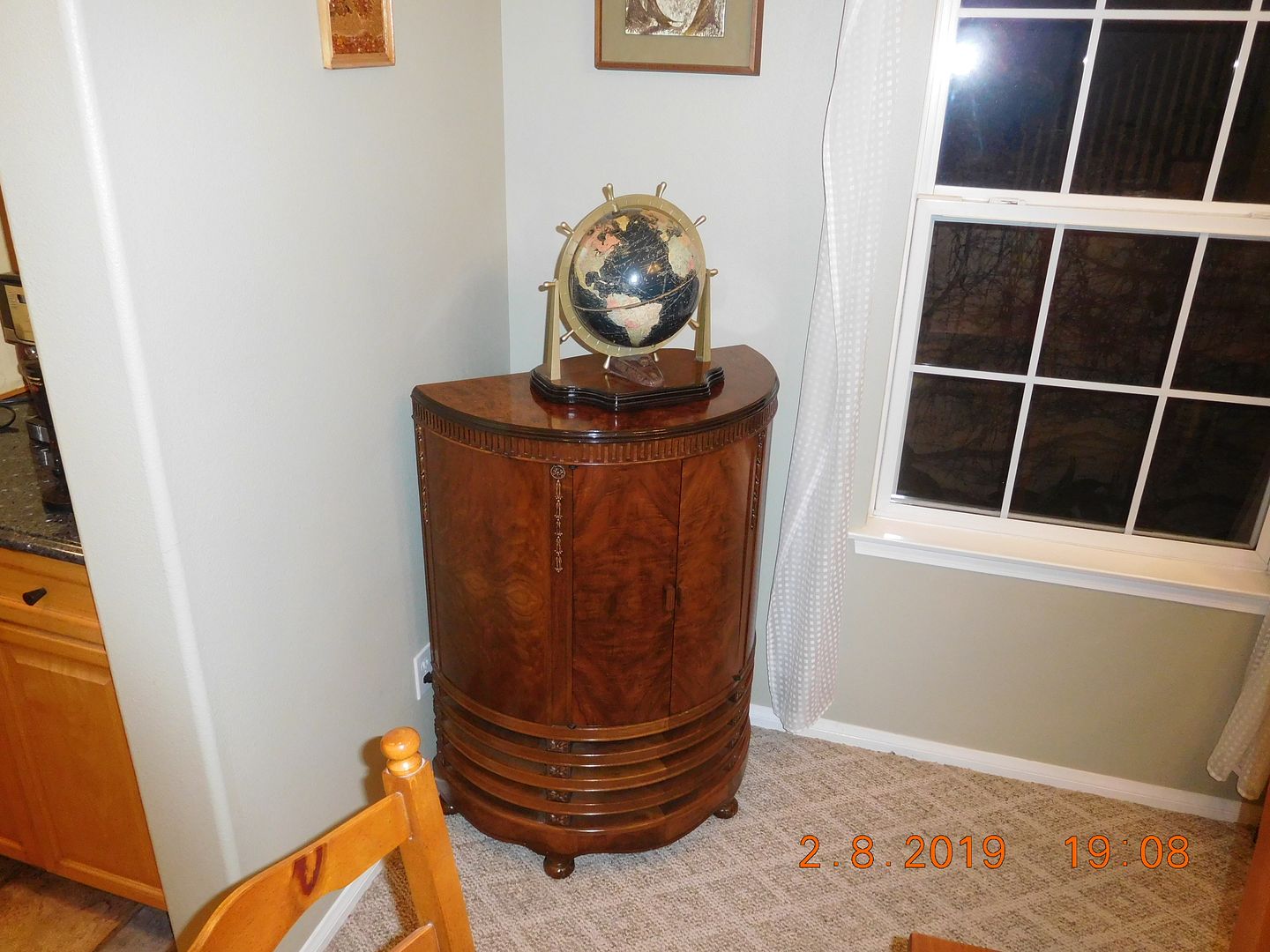

The cabinet needs nothing, as it is either a good refinish or a radio which was well-cared for and kept in a good location. It was surely expensive when new and probably was in a fancy house for many years. I was delighted to get it.
The Tenite escutcheon has some distortion, so I will have it laser scanned and the data manipulated to make a proper 3-D printed master, or even a new brown part for this and other 1938 Stromberg-Carlson models.

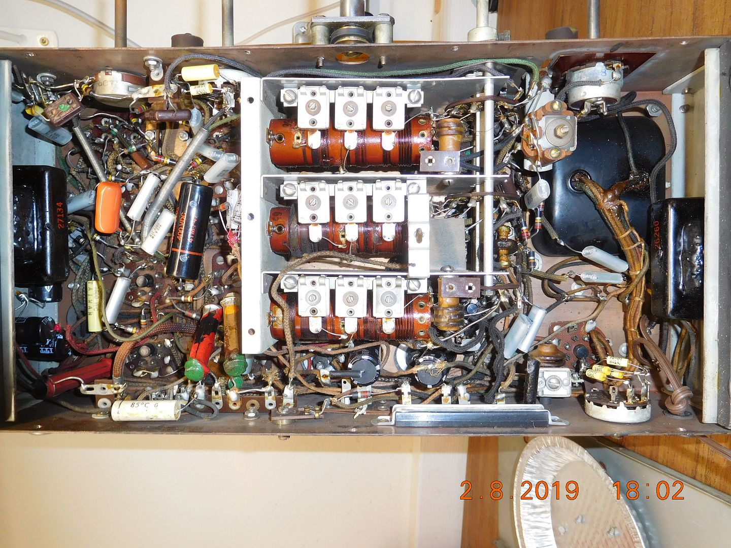

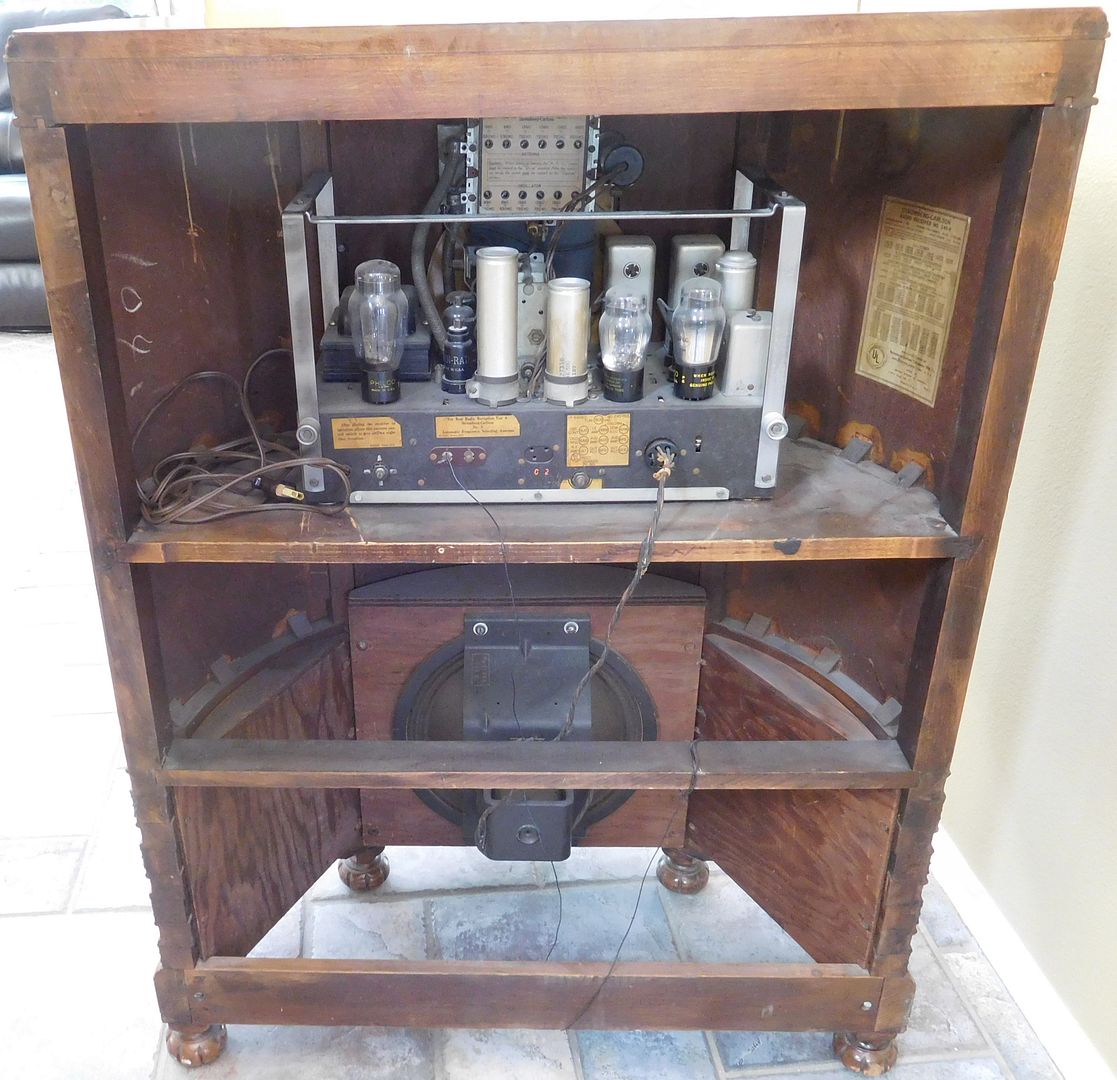

I will at least replace that big black plastic-cased capacitor, add a three wire cord and add a fuse, plus better secure the large power supply filter capacitors.
It looks very nice in a corner of our dining room, and the globe radio on top looks good (Rima's idea)

I got the three wire cord and fuse installed, and replaced that one old capacitor this morning.
It works, but needs work.
The tuning belt slips, so most of each band can not be accessed. I will replace it using the Radio Daze belt kit, a nice rectangular rubber belt you cut to fit and joint the ends with a drop of super glue. I was skeptical years ago when I first saw them selling it, but have used it and it works very well. You get good traction with the flat contact surface, and you do not need to dismantle all kinds of things as is necessary with a loop belt.

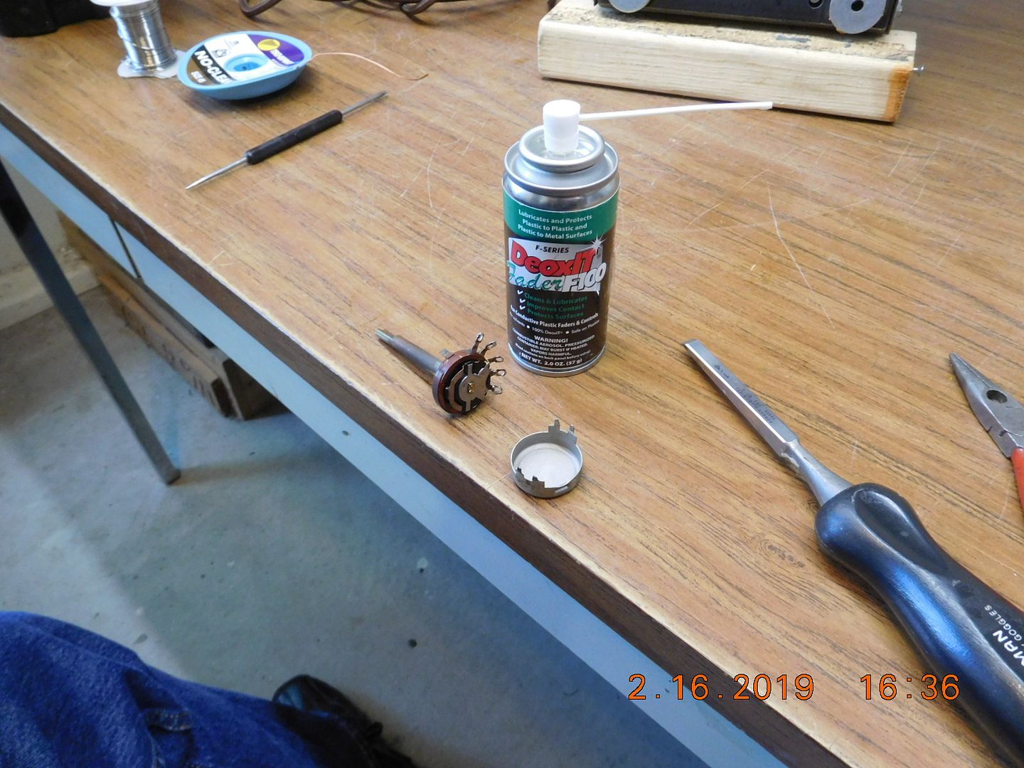

It squeals badly, apparently due to a dirty volume control.
 Post subject: Re: FStephenMasek's 1938 Stromberg-Carlson 245R
PostPosted: Feb Sun 17, 2019 4:49 am
Posts: 10412

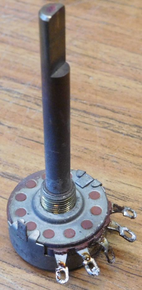

The volume control has five terminals! I was happy that Deoxit Fader Lube fixed it, as finding a replacement would be quite a challenge. Allen-Bradley is still in business, but I somehow doubt they would supply that part in 2019...

Stephen wrote "The volume control has five terminals! I was happy that Deoxit Fader Lube fixed it, as finding a replacement would be quite a challenge. Allen-Bradley is still in business, but I somehow doubt they would supply that part in 2019...
I found the tuning belt had been replaced with the Radio Daze kit, but the belt was too long, so I shortened it. I also lubricated the tuning mechanism. "
well, yes finding an Allen Bradley type J or an Ohmite type AB like you have would be tough, but tapped controls I have most anything anyone could want 1930-1970 or so. As to the tuning belt, I use a .140 round NON oiled O-ring, it works great and its even better on the motor drive sets, it wont "walk off". Just cut to snug, slip it around the "difficult" pulley and super glue. , push together and hold 30 sec, it will NEVER break, its cheap and one size works for all radios. Then you pull it over the "easy" pulley and done. Some radios would require a LOT of work to disassemble and install a continuous belt. Never understood why anyone would do that way (re: belts from Adams Mfg) or the original fabric ones ( have those too but rarely use them). I guess on some radios putting a continuous belt on is easy but not most.
