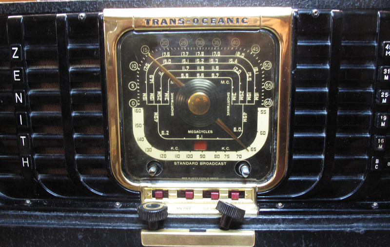

I took the plastic dial cover from the older TO to use in the newer radio, which was MIA. On the new radio, to install, I removed the brass plate via the twist tabs, removed the shards of the old plastic and put in the new one. It fits nicely and I think I have the right side out, but the spacing for the knobs is off enough to bind the knob and make tuning a chore. I can't find the sweet spot where both knobs clear cleanly. I won't tamper with the plastic as I'm sure it won't take much abuse. Just another small difference between these two to make you wonder.
Any advice appreciated, I was hoping to finish it up today but you know how that goes ...

Actually, I would attribute that more to shrinkage of early plastics more so than production differences. Notice that the plastic has also shrunk away from the brass bezel, leaving a noticeable gap.
Mark Palmquist makes new reproductions, I have one on my 8G005 and it looks very nice. It would also resolve the issue of binding knobs.
https://dialcover.com/

You are most likely right, and I understand sagging, wrinkling, and warping from age, believe me! His example is also clear, this old one has a nice yellow tinge, almost like aviator glasses.
Looks like "done" will have to wait for a few weeks, thanks for the tip!
