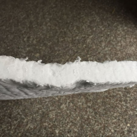

 Post subject: Re: Asbestos substitute
PostPosted: Nov Thu 08, 2018 10:17 pm
Posts: 10347
As mentioned: Heat Resistant High Strength Ceramic Fiber Insulation Mat Pad Blanket Placemat.
Specifications:
Temperature classification:2600F
Color: White
$14.33 Walmart # 570959863
