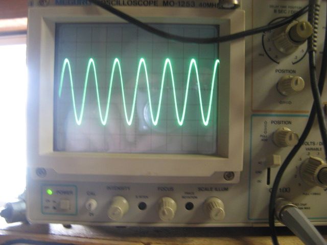

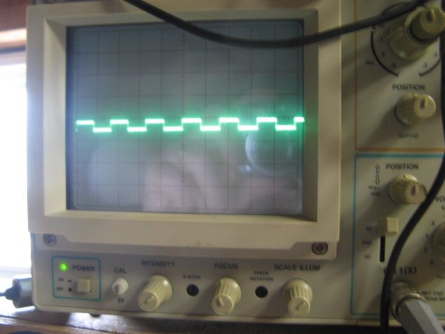

EDIT Just hit me, your version will no doubt work but is transmitting a sq wave vs a sine... I suspect it will have far less range than with load coil in series with antenna...

Mike I measured carrier waveform and signal output with both setups, first is with my circuit, second yours... No settings were altered on scope, so there is a huge difference in output, plus as I stated last night, yours is transmitting a sq wave... I tried several value coils from 82 to 1000uh, no real difference in any of them...

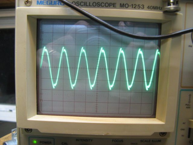

OK, I remember why I didn't use that configuration... Produces approx same signal but has harmonics(spikes on signal peaks)...

BTW I did reduce scope gain on that shot to make the waveform a bit clearer, signal was virtually identical on both versions... The 330uh produces more output than does a 150uh, with a AA5 tuning cap(and likely your cap) either can be peaked...
