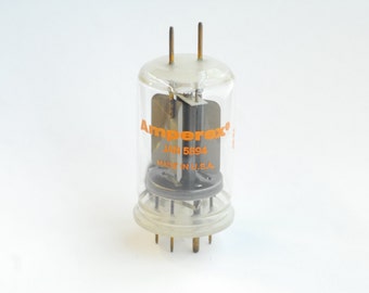

From the standpoint of kool-looking, how about this dual heptode 5894?
I think it was listed somewhere as an AF/RF power amplifier.
Is that true?
