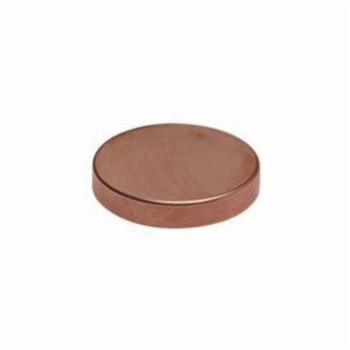

You may want to check out 1" copper test caps. Very thin and almost invisible compared to a standard cap.
