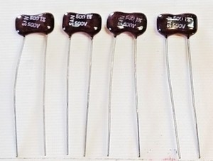

question time to ease my mind:
C17 is a tubular 0.0005 mfd capacitor on the 6N7. i have always replaced "like style for like style" meaning that i never used a ceramic disc in place of a film capacitor, etc.
since i did not have a tubular paper or film capacitor that is 0.0005 mfd, i replaced this capacitor with a silver mica 500 pf capacitor.
:arrow: i see absolutely NO reason why i cannot do this :idea: .
reason i am very particular about this amp is that it is mint, beautiful, and works perfectly. it is a piece of history and is a classic for the era and style. when it is done, i want it to be perfect as i am even more particular for those reasons.
i did go ahead and restore all the mic inputs this evening. when i turn up the volume on the mic inputs whilst playing the phono input, it does not shunt and cut out the phono input's audio. the audio is clean and each mic input does not hinder the audio anywhere in the amp. the coupling capacitors on the 6AU6 tubes only passed 10 volts, luckily, not 175.
each and every one of the "tiny chief" capacitors in this amp leaked anywhere between 5 and 10 volts.
thanks.

I don't think you really meant "tubular" like those hollow, ceramic tubular-caps found in RF circuits. These types.. NEVER fail.
I think you probably just meant cylindrical.shaped wax-paper?
So ...
Well 500pf is 500pf.... so why not?
And there is no DC voltage there either... so again... why not?
 Post subject: Re: Bell Amplifier Restoration Begins - Page 3 with Question
PostPosted: Jul Sat 20, 2019 12:17 pm
Posts: 20351
A dipped Silver Mica would be perfectly fine. Even a ceramic should be fine because there isn't any DC bias across it and being 500 pf I doubt it would have any microphonic effects, but a ceramic NP0/C0G would be just as good as the mica.

If you wanted to be a stickler electrically, you could series two .001 mylars which would be .0005, but then it wouldn't be as perfect visually.
I'm not sure which you would OCD on more. (I say that with 100% respect, as I understand fully)
