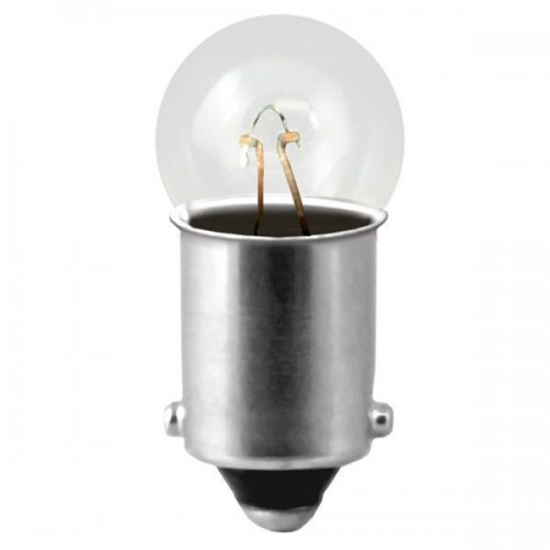

Hey guy's, been a little while. No, I'm not ready to completely finish it yet... I'd bring back the "restoration" thread if that were the case.
No, this is about the bulbs for the dial. My Lafayette LR-1500T keeps going through these things like there's no tomorrow. It uses bulbs that look like the old standard #44 or #47. Doesn't matter which I use. They only last a month or few and then I notice one side of the face is dark. Next thing I know, it's not lighting up at all. I have been using the stereo ALOT, but I don't think it's anywhere near the 1000 hours that the bulbs are rated for.
Anyone know what kind I should be using in the Lafayette LR 1500T? Operators manual does not show bulb types, nor does any of the schematics I have. I have read somewhere (don't remember where) that stated that the bulbs see 8 volts. That would explain the shortened life for me, BUT! What bulbs in that size can handle 8 volts? Google sure isnt helping me!

They're 8 volt bulbs.
This will work fine: http://www.vintage-electronics.net/bayo ... 300ma.aspx" -="window.open(this.href);return false;" -="window.open(this.href);return false;" -="window.open(this.href);return false;
You need the bulb with the longer glass top to completely light the dial.
Be careful. After 50 years, the printing on the glass will easily flake off or if you use water or anything stronger to clean the glass on the print side, you run the good risk of wiping it off and/or smearing the print all over the place.
You could use typical #47 bulb but you would need to add a dropping resistor, or some other component to drop the voltage by at least 2 volts to make the bulb last. (depends on how much work you want to put into lamp modification)

What I call short and long glass lamps. Unfortunately picture comparison scale is not the same.
The lamps should also have a shroud with a cutout directing the light into the side of the dial glass.

As designed, the receiver requires 8 volt bulbs. The transformer winding is that voltage. If you use #47 or #1847 or any roughly 6 ~ volt bulb, you will burn them out very quickly. I believe all this has already been mentioned.
Now, for some applications where an 8 volt bulb is used, and high brightness is not required, you sometimes can get away with using a 12 volt bulb. All the 8 volt bulbs that I use to buy at Parts Express and MCM all came from the Far East.

Bayonet bulbs is what the Lafayette used. The link I provided for the 8 volt bulbs will work fine.
