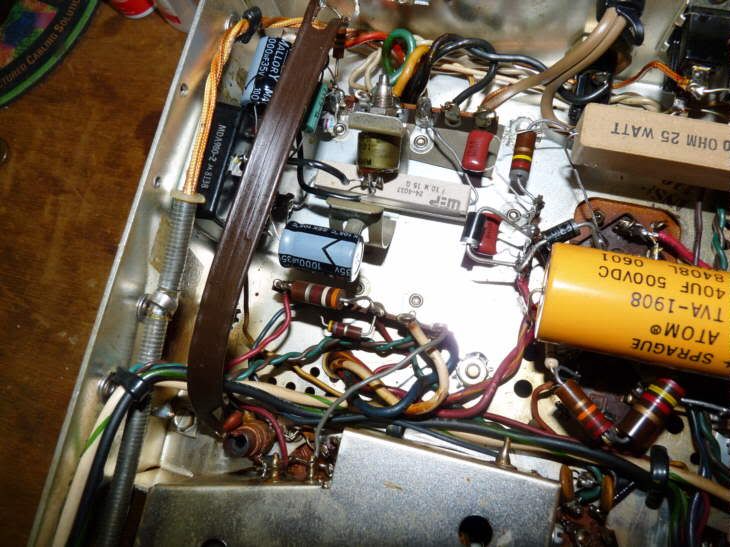

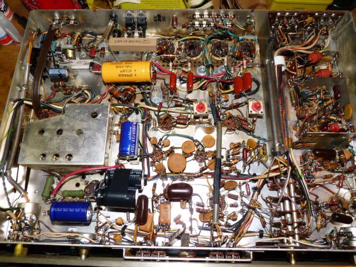

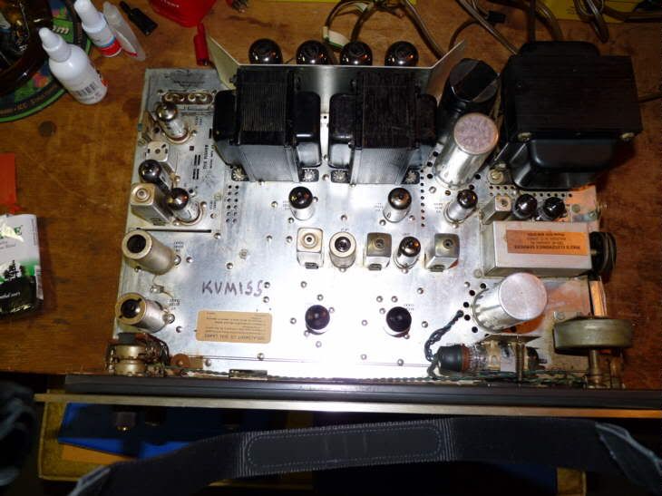

Fisher 400, top view:
The original filter cap cans are still in place. Two of the cans (the two next to the power transformer) date from this unit's 1977 overhaul, and are still in use. I was unable at the time to get exact-value replacements for the two cans, so I had to add supplementary filter caps underdecks to make up the proper values.
The output transformers came off a carcass 400 I had been holding for years, just in case. A replacement power transformer is still on that carcass (again, just in case! / knock on wood!).
Complete bottom view:
So far, I have had to do nothing significant to the radio section of this unit, apart from replacing a tube or two along the way. Same for the multiplexer unit (upper right-hand corner). I replaced the eye tube in the 1977 overhaul, and it is still in use.
All lytics and mylar/film/paper caps have been replaced. I weeded out the last of them in the 2009 overhaul.

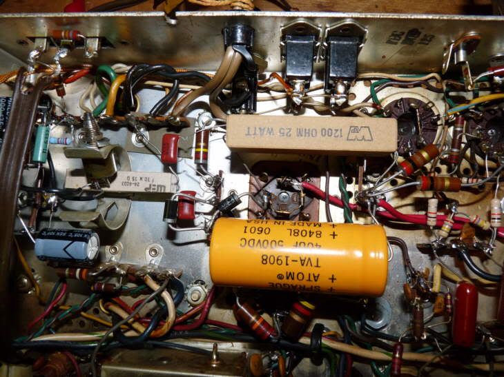

Power supply area:
The new rectifier diodes, safety caps, and several replacement resistors are in plain view. The large "Atom" cap supplements an undersized section on one of the 1977 filter can replacements.

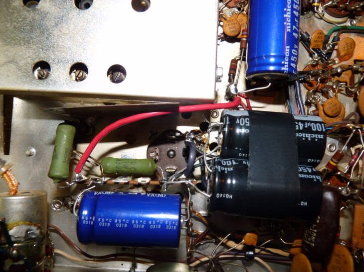

Final filter area:
The filter can in this section was taken out of service in the recent overhaul. The individual lytics replace it. I had to add a terminal strip to mount some of them, along with their associated power resistors.
The notorious Fisher power switch, so prone to failure, is visible in the lower left-hand corner. It happens that this one is still good.
Bias supply area:
The new silicon bridge is mounted on the chassis where the old selenium unit used to be. The two small lytics replace the dual-section filter can that was mounted in the clamp (visible to either side of the white "WP" power resistor). All resistors have been replaced. The bias trim control that I added (a small sealed Allen-Bradley WW pot) is mounted on a wing of the clamp. Its only drawback is that it can't be adjusted from the top of the chassis. You have to go underdecks to get at it.
The replacement silicon bridge is a Motorola MDA-980-2.
Output stage area:
All resistors and caps associated with the output stage are replacements. You can see that those four novar sockets have been hot (you betcha they'll never get anywhere near that hot again!). The 200-ohm screen safeties and 12-ohm cathode safeties are my additions and not part of the original design. Furthermore, the grid bias resistors have been brought down from 330K to 270K. Swamper resistors remain at the original 1K.
I have logged upwards of 200 hours on this unit since October, and (knock on wood again!) so far, so good.
I hope these pictures will help anyone with another 400 to overhaul. It can look daunting underdecks on first impression, but after you zero in on it, section by section, it's very straightforward and easy to follow.
Happy 4th of July to one and all!
:wink: Larry
