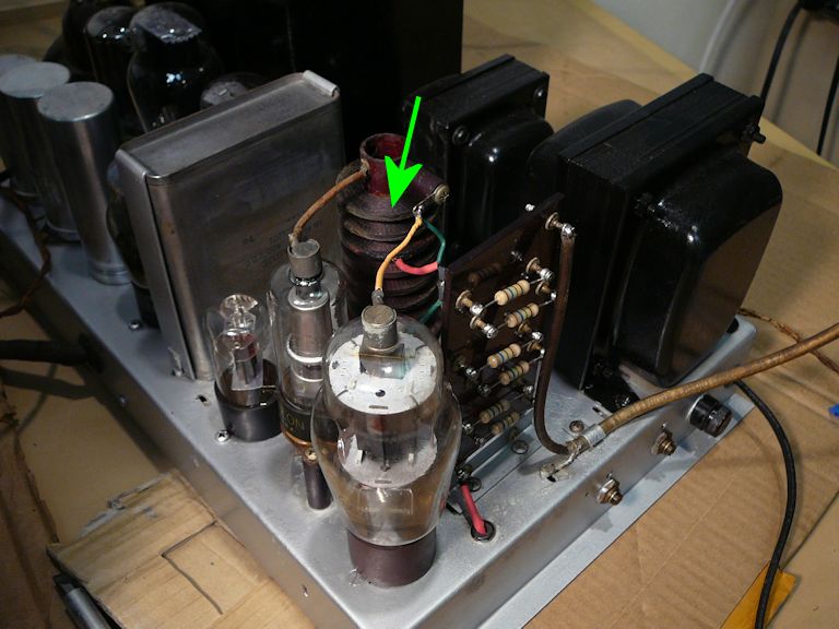

The top connector was torn out and then someone tried to solder back onto the hank of wires hanging off the coil. There was some odd monkey business on this TV, in the HV section and elsewhere. All of the grid cap connectors have been crudely replaced. I don't know if someone cannibalized them to use elsewhere and then later replaced them, or if there was some misguided attempt to restore low/absent HV output. The repairman also eliminated the 500pf/10KV doorknob cap and covered the remaining parts with gobs of electrical tape (allowing replacement of the 12LP4 CRT with one that uses an aquadag HV filter??). There's more, but you get the idea.
I did my best to clean up the mess on that transformer connection and resolder it, but the best output I got was about 1.5KV before corona spots appeared on the coil and the output dived to zero.
As for repairing the original, when I examined the transformer more closely, I found a loose wire hanging out in the breeze on the far side of the top pancake. So there is more than one damaged spot needing repair.

It was extremely helpful of you to post the link to the power supply schematic diagram. Scrutiny of it confirms that the Miller #4526 R.F. high voltage coil can not replace the coil in the RA-102.
Coils like the 4526 are specifically designed for power oscillator circuits employing Armstrong/Meissner feed-back via a “tickler” coil. They tend to work at 50kc or higher, and have a primary winding tuned by means of a variable condenser.
Your new photos clearly show a coil with a much lower self-resonant frequency; and the diagram shows that the coil is tapped, and has no primary or tickler windings.
The high voltage power supply of the RA-102 works differently than the R.F. types in other television sets. The left half of the 6SN7 is a blocking oscillator (triggered, as you say, by a synchronising signal from the horizontal oscillator circuit, likely so that the high voltage output will be dependent on the existence of sweep). The signal of the blocking oscillator, which is a pulse-type waveform, is amplified by the 807 beam power tetrode, of which the high voltage coil is the load. After each pulse, the magnetic field of the coil suddenly collapses, inducing a very high voltage on the output terminal. Because this circuit is synchronised to the horizontal sweep, the self-resonant frequency of the coil must be just above 15kc.
In the event that a correct replacement coil can not be found, there are few options to retain authenticity other than repairing the original coil, or having a replica or similar coil wound.
Otherwise, since the resonant frequency of the coil is the same as that of a flyback transformer, it may be possible to adapt one of the latter. Flyback transformers were driven by beam power tubes, so it may be possible to find one that will match an 807 without any changes to the load winding.
Still another possibility would be to use a Miller 4526, changing the circuit in the set to its type, as shown in the data sheet, or the Li’l TC diagram. You would have to provide a circuit to make the high voltage output contingent on the presence of sweep, if you desire to keep that function.

It will probably be very difficult to find an example of the existing high voltage coil, short of locating an otherwise irreparable set.
The 6BG6, a standard horizontal sweep tube, is indeed comparable to the 807. In principle, a flyback transformer for a set with a 6BG6 horizontal output stage, and a 10KV or slightly higher accelerating potential, should work in the RA-102 high voltage power supply. The main winding of a simple flyback transformer is tapped, creating an auto-transformer, just like the coil in the RA-102. Any additional windings or taps, except for the link for the high voltage rectifier filament, can be disregarded.
If a test shows that this plan will work, and there is space, the flyback transformer could be mounted above the existing coil.
I suspect that the original coil can be repaired. You mention that the wire on the surface of the top pie is broken and loose. This alone could explain the observations you have made. Surface damage like this can usually be repaired without the necessity of re-winding the pie on a coil winding machine. Do you have a photo that shows this damage on the coil?

The close-up photo posted earlier is the best that I have. It looks like several wires were torn loose from that pie winding somehow.

You are correct. I am sorry I wasn’t clear before, but none of these “high voltage oscillator coils”, of which many types were made from the 1940s to the 1960s, will work in your DuMont RA-102, in the existing high voltage power supply circuit. These coils were intended to be used in power oscillator circuits, with magnetic feed-back, and they worked at much higher frequencies.
The original coil in your set is an “R.F. coil”, in that it is self-resonant at a frequency that is considered to be part of the usable R.F. spectrum. It is resonant at the horizontal oscillator frequency, because the 6SN7 blocking oscillator that feeds the 807 power stage is synchronised to the horizontal sweep. This frequency, of just over 15KC, is lower than employed in “high voltage oscillators”.
Your original coil is a simple self-resonant auto-transformer, consisting of a single, tapped, winding.
Because a flyback transformer of that era is also an auto-transformer resonant at the horizontal scan frequency, it essentially works the same way, in so far as the generation of the high voltage accelerating potential is concerned. Your coil has more turns of wire because it has an air core.
As I described above, I suspect that a flyback transformer for a set of that general era, using approximately the same 10KV accelerating potential, could work in your circuit. A great many flyback transformers of this kind survive as used or “new old stock” items. Since they are so common and inexpensive, I think it would be worth trying one, if you are unwilling or unable to repair the original coil.

I'm not entirely sure about this, but I *think* RCA used a simple tapped winding (e.g., autotransformer) air core type flyback in some of their sets for a year or so around 1950. I've seen one, and it had a narrow single pi secondary winding of fairly large diameter (e.g., around 3 inches) wound over a broader primary winding, with just three wires coming out: starting end of primary, junction between primary end and secondary start, and secondary end as a flying lead with clip to attach to HV rectifier tube cap. It also had a 2-turn winding for the HV rectifier filament, and everything was wound on a hollow phenolic tube about 1 inch diameter and 3 inches long. Although it was constructed differently from yours, and apparently would have a larger footprint, I think it was designed to run at the horizontal 15.75kHz frequency, not RF, so I wonder if one of these might work for you. ETF posts on-line a list of parts they offer to television restorers, and they might have one.

Thanks, that's interesting. I peeked at a few 1950-ish RCA schematics, looking for something other than the conventional flyback. Are you talking about this sort of transformer?

I'm pretty sure that's what he's referring too. Here's a picture of one.

Merit HVO-34 and Thordarson FLY-45 are listed subs for the RCA part number. ETF lists 3 HVO-34 available.
http://www.earlytelevision.org/flybacks.html
Tim
"One of the advantages of being disorderly is that one is constantly making exciting discoveries." A. A. Milne
 Post subject: Re: HV transformer: Thordarson HVO-50, Merit TV-231
PostPosted: Oct Wed 05, 2016 7:25 pm
Joined: Jan Thu 01, 1970 12:00 am
Posts: 5521
Location: Woodinville WA 98072
Thanks, that is very good to know. Maybe I'll ask ETF to measure one of those. Offhand, it looks too big for the available space, so if I installed it I'd need to fashion a bigger HV cage somehow.
I'm also going to contact some transformer rewinders and ask if they would take a crack at fixing the old transformer. I have a general idea how this could be done, but my micro-surgery skills aren't the greatest, and if I'm going to practice, I'd rather experiment with something less unobtanium than this xfmr.
Regards,
PostPosted: Oct Thu 06, 2016 12:15 am
Joined: Nov Fri 30, 2012 2:35 am
Posts: 694
Location: Phoenix, AZ
Yes indeed, that's the transformer. The diameter may be a challenge for you, but I wonder if it otherwise might work. Best of luck.
R/ John
