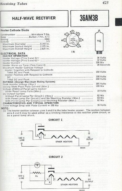

I have an excess of the 100ma 18/36 volt AA5 tubes that I would like to put to use in some of my sets which have a pilot lamp. As you may know, the 100ma tubes came late to the tube radio party in the early 1960s, being the 18FX6, 18FY6, 18FW6, 32ET5/34GD5 and of course the 36AM3 rectifier. As far as I have ever seen, no set originally using this lineup ever had a pilot lamp, and the tube manuals seem to give conflicting and vague advice on the use of a pilot lamp with the 36AM3 tube. Some such as RCA said the heater tap can only be used for current limiting and not to drive a pilot lamp. Sylvania from what I have seen said it could, but gave no advice on what type bulb would work.
Digging through Google, I saw a reference that said in passing the heater tap would in normal use only be 4 volts anyway. I assume that would mean if I want to swap this set of tubes into a set with a pilot lamp, I'd need to replace the existing bulb for one rated for 4 volts and I assume 100ma.
I know I can keep the existing standard 150 ma tubes and call it a day, but I'd like to make use of these and it would be an interesting learning experience to see if I could settle the heater tap question for the 100ma 36AM3 and see if it would work with the proper bulb without re-wiring the radio (simply by finding the right bulb to work with the 36AM3).
Thoughts? I had not found much searching Google for a 4V bayonet base bulb. So perhaps the reason the tube manuals are vague about using a pilot lamp with the 36AM3 is because such a bulb compatible with the voltage and current involved doesn't exist and nobody picked up the gauntlet to make such an animal.

The GE datasheet for the 36AM3 says:
The heater tap is provided to allow a portion of the heater to be used as a current-limiting resistor (See schematic). It is NOT intended for panel lamp operation.
Emphasis mine.
Datasheet here: https://frank.pocnet.net/sheets/093/3/36AM3.pdf

BOTH -- Sylvania & Tung-Sol say tap can be used for dial lamp tap.
Sylvania was the designer & registrar of tube.

Interesting to note that no manufacturer recommends connecting a pilot lamp to the 36AM3/36AM3A versions of this tube. Sylvania and Tung Sol say it can be done with the 36AM3B version, but it appears a shunt resistor is essential for such operation—and they don’t tell you the value, which means you are on your own if you do it. The B-version has controlled heater warm-up time, and this may be necessary to support a pilot light. Maybe RCA and GE never listed the 36AM3B.
Zener diodes and LED pilot lights were not around when these tubes were developed so it might be possible to come up with a modern way to add a pilot light to a set with a 36AM3/A. But it would take some experimenting and maybe the loss of a few tubes or diodes before the right “formula” was found.

One watt zeners across lamp are fine. I've not seen a heating issue using ½w.
If you have a 36AM3(std, A or B, I ain't picky) with burned out tap, could use the zeners and retain the #47 lamp. Using a #47, 7.5v to 8.2v zeners perform nicely. With zeners in series & opposite polarity, the pair give a voltage based on .707 of 60 cycle sine wave

 Post subject: Re: What type of pilot lamp bulb would work with a 36AM3 tub
PostPosted: Jun Wed 19, 2019 8:53 pm
Posts: 3291
That data sheet answers the question, the correct pilot lamp is a CM8-54, whatever that is. CM might stand for Chicago Miniature.

The 36AM3B is rated at 580 mA peak ( the 3 and the 3A were 530). The B had 20 second warm up time. But RCA, in RC26, (1968) stated the heater tap was not to used as a pilot light voltage source.
