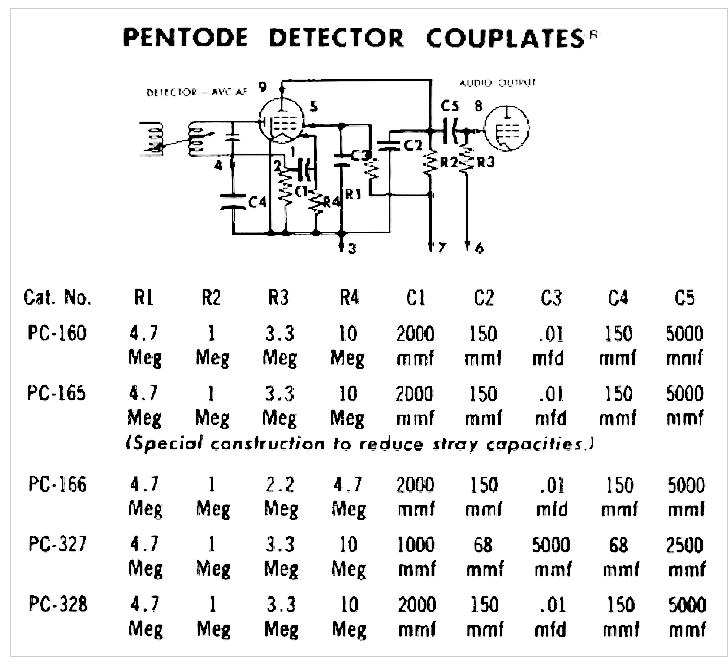

Hello. I am rebuilding a Jewel 5310 for a test bed for a inverter battery eliminator to measure rf interference. I have a Betmans schematic but it doesn't quite match what I have. The schematic shows a pc-160 couplet, but I have a pc-165. The schematic shows a battery saver switch that mine does not have. Also the build seems to be whatever surplus they could source that day. One 30pf coupling cap is obviously military surplus. The trials of working on a cheap radio.
Can someone point me to a listing of schematics for couplets?

Centralab PEC (packaged electronic circuit) couplate PC-165 has all the same values as PC-160
It was "special construction to reduce stray capacities".

Hello, I hope you get that info, but if not, the Model 5010 has the same basics but has all discrete components.
http://www.nostalgiaair.org/pagesbymode ... 009719.pdf
Unfortunately the data base doesn't cover your later version.
I'll bet there are minimal differences between PC 160 and PC 165, and the radio will likely play fine with the original configuration.
