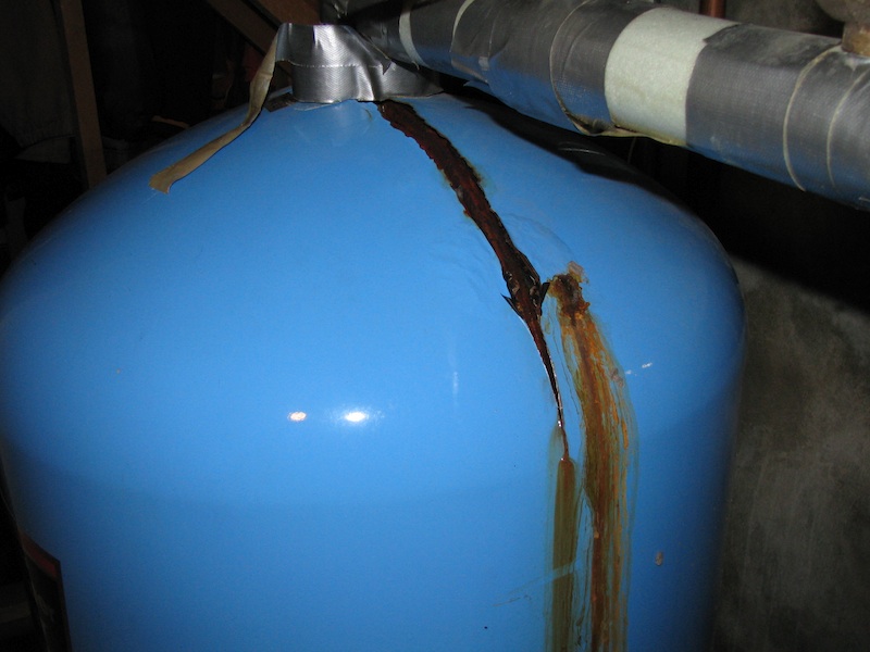

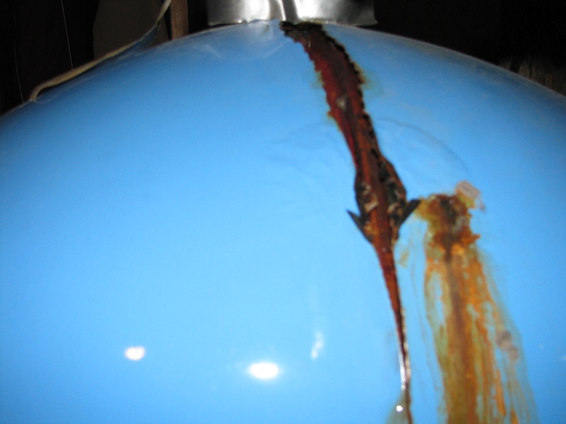

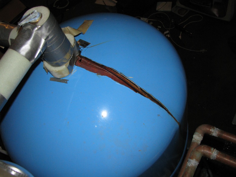

Consider yourself lucky that the issues of your water heater showed itself like that. Our 25-year-old water heater (indirectly fired via our oil furnace) all but blew its top several years ago. We came home from a family outing to hear the sounds of water hitting my brother's drumset in the basement, and found that large amounts of water was spraying from the top of the tank. Here's what the tank looked like after I shut the water off:

Your pressure relief valve must have locked up. It should have popped off long before the tank ruptured.

Could very well be. I don't know how old it was (possibly as old as the tank itself, which was installed around 1984 or 1985), or if that foam wrapped around it had anything to do with it locking up. The new water heater (indirectly-fired, like the old one) is actually smaller in diameter than the old one was, though I'm not sure how their capacities match up.

Tank liner looks like it failed, and it allowed the steel outer shell to rust through. Those indirects also need a vacuum relief to protect the liner.
