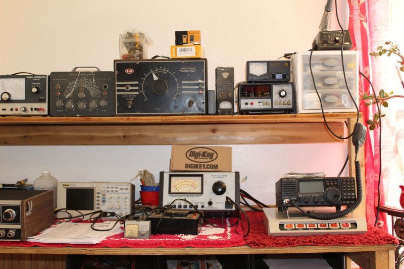

Since we have been discussing test equipment, I have tried to include some pictures. (Photobucket) Here is the Sig Gen lineup on the top shelf from left to right.
Leader LSG-16, Heath SG-8, B&W 200
[url][URL=http://s372.photobucket.com/user/langgatruck/media/Sig%20Gen%20Lineup%20800p_1.jpg.html]Image[/url][/url]

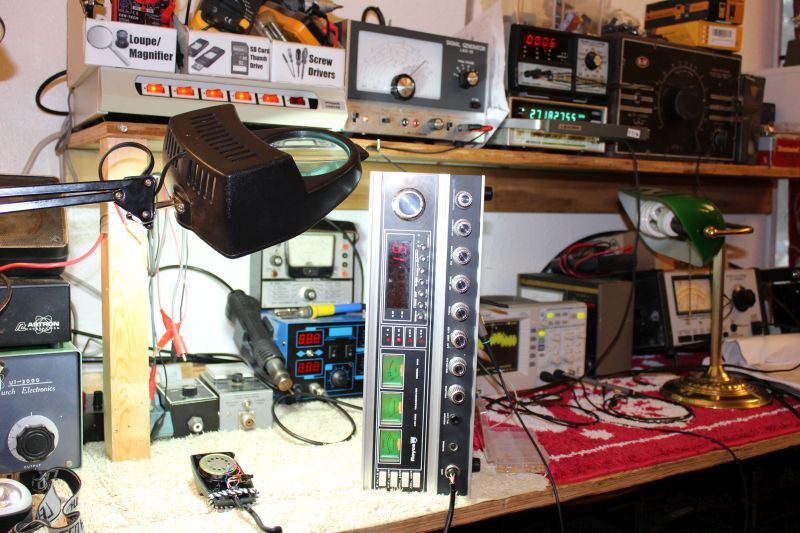

The Leader seems to work pretty well I have double checked it with a freq Counter LDC 823S which I bought on Ebay due to this project.A little trouble with the band selector switch which could use some DeOxit. The older sig gens need work.
You can see my new frequency counter barely in this picture with the blue LED display. How accurate is my counter? Gut feeling its ok but someday I will have to check against a known standard.
[url][URL=http://s372.photobucket.com/user/langgatruck/media/second%20pic%20in%20%20post_2.jpg.html]Image[/url][/url]

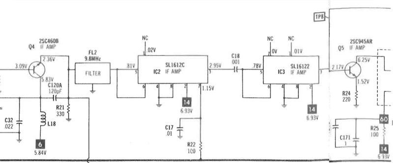

As I mentioned previously there is a no AM receive symptom on this radio as well as weak USB and LSB. After following the alignment procedure faithfully, which adjusted the power supply and set some frequencies on the Phase Lock Loop circuits finally I get to inject some modulated 9.8 Mhz on the base of Q5. I cant hear the 1Khz tone on AM but when I switch to USB or LSB I can hear it. The base of Q5 is right where the AM and sideband signals from the IF part ways. I suspected Q5 as the collector had expected voltage but emitter and base are at about 10 to 12 millivolts. Transister was pulled and checked front to back ratios with my Harbor Freight multimeter (I laugh but those little free red meters work for some things.) . I think the transistor is good.
with Q5 out, IC3 pin 3 still has negligible signal. P-P voltage is only about 30 to 50 milivolts.
[url][URL=http://s372.photobucket.com/user/langgatruck/m[URL=http://s372.photobucket.com/user/langgatruck/media/fourth%20pic%20in%20pose.jpg.html]Image[/url]edia/third%20pic%20in%20post.jpg.html]Image[/url][/url]
I have misdiagnosed IC's before and purchased them and it did not fix things. Still.
I found the IC for $12.00 shipped or 3 for $20 and ordered three. btw its actually an SL 1611C not whatever it shows in the picture or in the parts list.

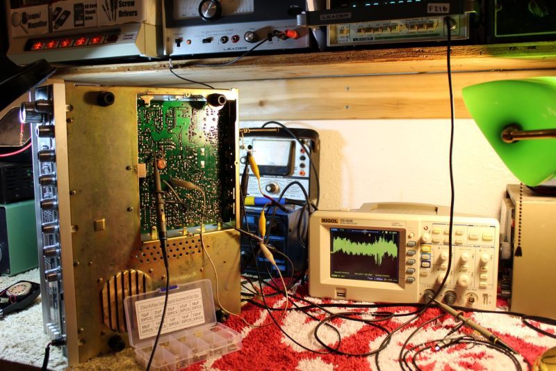

Here is the underside of the radio showing my Rigol software scope DS1052E which I am starting to like better. Just takes getting used to having a 1 or 2 second delay to see the results on the screen.
[url][URL=http://s372.photobucket.com/user/langgatruck/media/last%20pic%20in%20p%20ost.jpg.html]Image[/url][/url]
