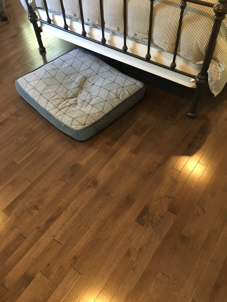

My brother just got finished redoing the dining room floor in his historic house, built sometime between 1823 - 1829. Can anyone identify what type of wood it is? Nobody he's asked seems to have any idea. It is unknown when this floor was installed, it's quite possibly original. He said it was hard as a rock to sand, and was very light in color. He used Varathane "Early American" stain in the pictures. The house has a pretty colorful history.

Maybe... Maple?
Here's some Canadian Silver Maple:

That was what I thought - maybe Rock Maple - but someone he asked said they didn't think it was Maple, so I figured I'd toss it up for debate among the most knowledgeable group I know of....Like I said, he said it was like sanding concrete, and he blazed through sanding supplies, yet it sponged up the stain and poly - it took somewhere around 3 gallons of each.

I think that's it!

I see some nice sections of curly maple and a little birdseye in the first picture. There is some curly in the second. The third picture is probably maple, but is modern. Beveling and micro beveling began about 30 years ago with engineered flooring. It is also done on prefinished solid wood flooring. In both cases the flooring can't be sanded after it is laid, so to hide the lack of flatness the edges are beveled. The planks are also narrow and short.
Narrow became normal after 1900 and short is now common in "character" flooring which has some curl or other fancy grain. So, my guess is that none of it is antebellum. The exterior picture shows the rear portion is the old part of the house and it probably had wide planks originally. The front section is newer, probably contemporary with the narrow planks.

My first vote would have been Maple, followed by possibly Butternut (white Walnut) except that Butternut is not really hard.

I am voting maple as well.

Looks like Maple to me and I am jealous as that floor will out last all of us.

Any possibility it's Chestnut? Tough to tell in a photo but almost looks like it could be.

When I saw the floor photos, my first thought was Walnut, but then I wondered who would waste figured Walnut on floors. That's why I mentioned Butternut (aka: white walnut, formerly plentiful, now endangered, but similar grain and figure to Walnut). Walnut isn't always dark, and now I wonder ... if it was/is so plentiful on your place ... maybe that's what's on the floor ... especially if a sawmill was available?

The darkness of the floor is the color stain he used - "Early American". The floor when sanded out was actually quite light in color. When that floor was laid would also dictate what it is. The original builder was a wealthy land speculator during the construction of the Erie Canal through this area (Lockport). The stone used to build it came from the stone excavated building the locks up the Niagara escarpment - I'm sure that it was finished using materials fitting a person of his stature at the time. The governor of New York, Washington Hunt, lived there for a time too, before building a huge stone house across the road.

The first photo strikes me a possibly cherry wood because at least in my experience cherry can sometimes have an unusual grain pattern like the first photo, or it could possibly be maple as the other have stated, either way that's a beautiful floor as others have said! For being that old, it's in amazing shape!
