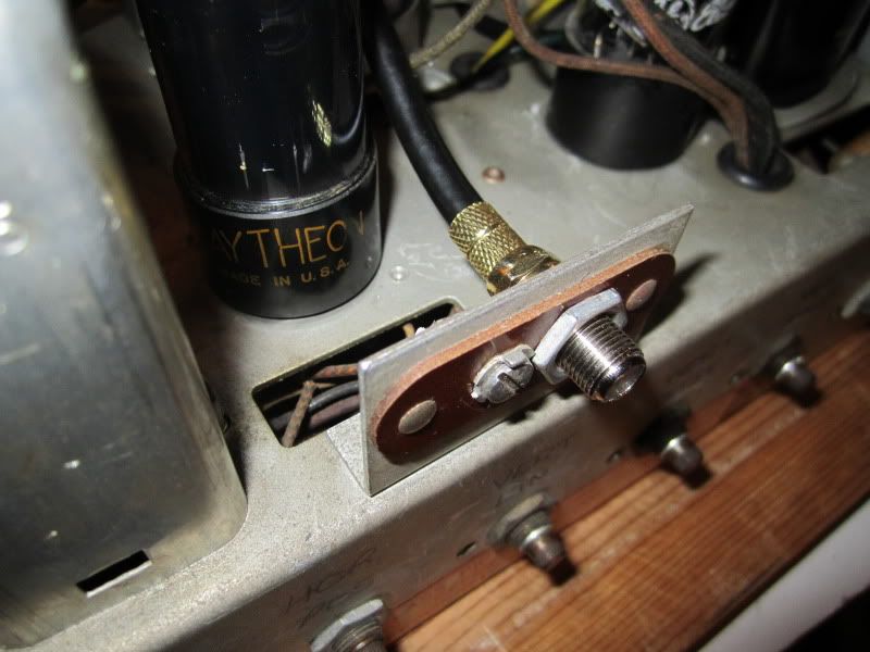

A more secure antenna connection on my Stromberg-Carlson DuMont RA-103 clone. Works well because DuMont used a 73 ohm lead to the Tuner:

M3 - I've thought about having the coax run directly to the set. It would be more secure, and hopefully remote ALL distortion from antenna cable. How did you attach the other end of the coax to the tuner circuit? Also, do you know if it would work on my 48-1000? Below is the output I'm using to the set. The converter dongle in the photo is the one I've since attached directly to the antenna socket on the set. The coax running into that dongle comes out of the RF modulator. Is that able to run directly to the tuner circuit?

The coax was already present in the DuMont chassis. I just trimmed and attached a female screw-on connector on the end, then drilled an oversized hole in the mounting board, added a female to female extension to the coax, and secured it with a hex nut.
I don't know whether 75 ohm coax can be directly substituted for the old flat wire antenna. Perhaps others can chime in. Balun Connectors are used for a reason, I believe. 8)

Using twin lead can be tricky. To work correctly the twin lead needs to be kept at least 6 inches away from everything. And if it has to be closer to anything than that then each of the wires in the twin lead has to be exactly the same distance from things.
Looking at the schematic for your set, it looks like you might be able to run coax to the tuner. Try connecting the shield of the coax to the case of the tuner near where the twin lead attaches. Disconnect the twin lead and connect the center conductor to one of the terminals where the twin lead connected with the other one not connected to anything. See how that works. Try switching the center conductor to the other terminal and see if there is any difference. If everything is perfect there will be no difference.
That is all based on the schematic being correct when it shows that the antenna coupling coil has a grounded center tap.
