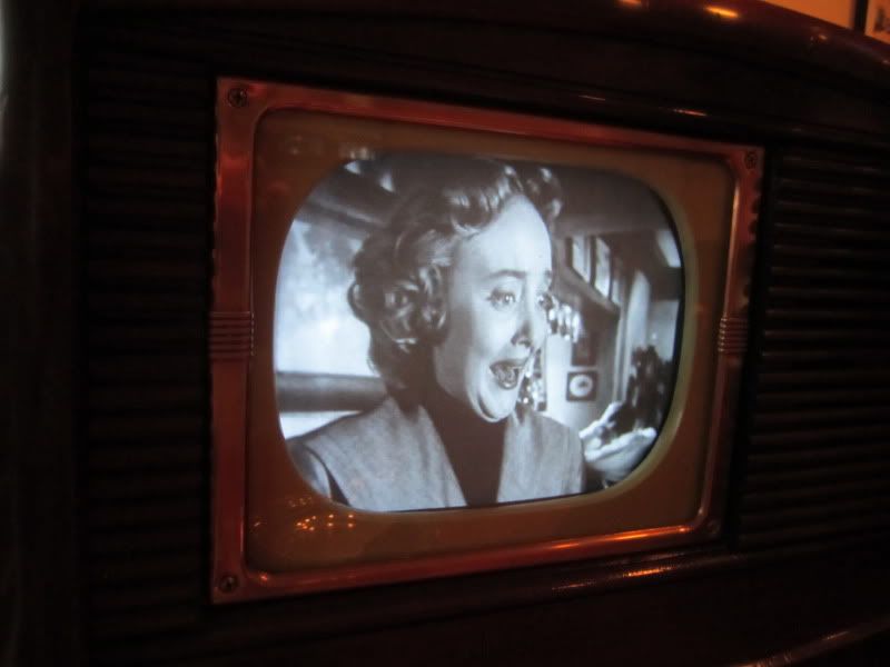

I'm thinking those pink caps have been replaced at some time, as on my 48-1000 almost all were the wax paper types.
You are likely going to find that not only the paper and electrolytic caps need to be replaced, but also a good number of those resistors have drifted a ways as well (the cathode bias resistors especially were as much as 100% high). Fortunately there's plenty of space to put in new electrolytics underneath without disturbing the cans on the top.
I still have issues getting the sound to work properly, it's my understanding that the sound carrier level was much higher in '48 than it is now. Maybe that's it.
Haven't powered it up in a few years, until today. Quick and dirty pic done with my iPad.

Looks good! I think there's hope for mine.
