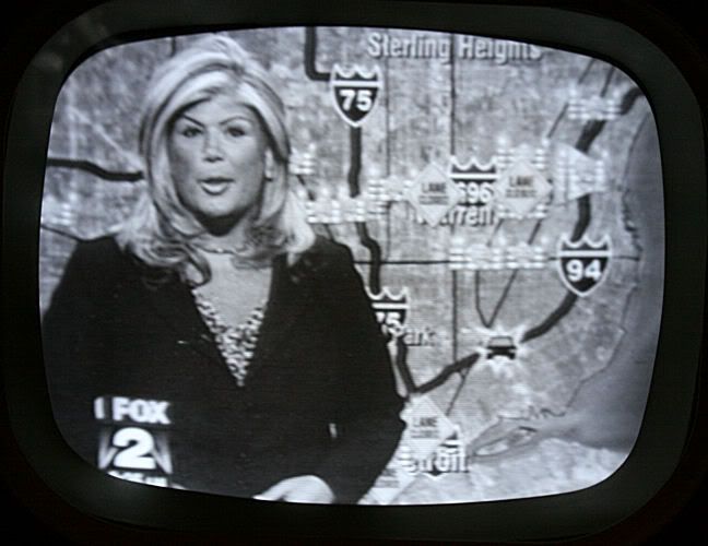

I subscribed to a free month of Showtime via my Roku device.
I've watched several great series on Showtime this month.
One series I'm currently watching is "Masters of Sex" - a
well made drama series set in the late 1950's about the famous
sex researchers Masters and Johnson. I'm not an entirely "dirty old man"
as I enjoy the period appointments - there are a lot of different 1950's
TV's, cars, cloths, telephones, office furnishings, etc.
On Season 1, Episode 7 they show apparently a Sylvania Halolight TV
much like the ones shown here in this thread. I rewound, paused,
and took this picture with my smartphone camera:
