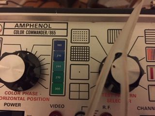

If you can't get it, send me a PM. I have this pair in stock, if that's what your's calls for.

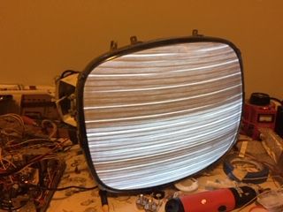

Okay gang, I've got another update with my 10L43, a TV that is hell bent on resisting all efforts at resurrection, that just wants to remain dead. Well I keep fighting it, and inch by inch I've made progress. I've done further work on the tuner, and I've gotten the first semblance of an actual image! But the image I've gotten is a heck of a puzzler.
So I'm using a signal generator that outputs a variety of calibration patterns, including bars, dots, lines either horizontal, vertical or both in a grid pattern, etc, etc.
I hooked up my geneator to the set, and began to adjust the controls on the chassis, as well as the generator. And I got an image...sort of. Below is a shot of the screen.
There's a great deal of noise, but you can clearly see a series of horizontal white lines. They are stable and most definitely an imagine from the generator, as they disappear when I shut it off, or change channels.
The problem is, the generator is set to out put a grid. I should be seeing vertical as well as horizontal lines. And when I toggle to other image outputs, like dots, or just vertical lines, they disappear. {below is an image of the various signal outputs I can choose from:]
So I'm only getting an image when there are horizontal lines, and if there are vertical lines, they don't appear. I'm only getting half of the image I should be. It's really baffling.
What say you all? Where should I look next?

To me (and I haven't worked on a tube TV for 30+ years), it looks like your horizontal hold is way, way off.

Because a TV image is scanned horizontally the vertical lines in a grid (crosshatch) are very brief pulses on a scan line. With the horizontal scan frequency off so much the vertical lines are smeared to the point you can't recognize them. Dots are the same case. Get the horizontal frequency right and sync up and you should be able to see what you are expecting.

There is something additionally going on, the screen look like the problem is not only the horizontal frequency.
Maybe the yoke is rotated causing the lines to slant more than they should. I wonder about the horizontal being off so far, I would think the H.V. would be effected more. I suppose the vertical frequency is off also.
