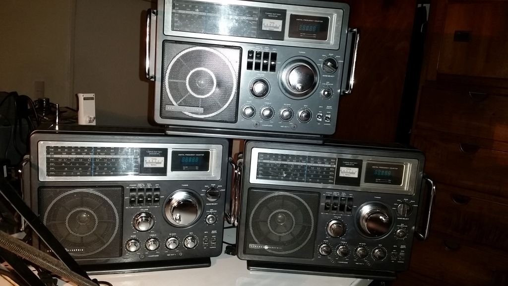

I bought a GE NO-7-2990A at auction, mainly because it looks cools and reminds me of the shortwave set that I had as a kid. This radio features the cracked gear in the tuning mechanism which creates the "bump" which is annoying but it still tunes. Otherwise it is very clean.
Apparently there is a fix for the issue, does anybody here know how to apply this fix?

What if you use Crazy Glue to fix the gear?

DO NOT USE CRAZY GLUE!!!
I have a detailed procedure to fix this problem. I have repaired 20+ radios with this problem and had 100% success. PM me your e-mail address and I will send you a scan of the procedure. Its very detailed.
Regards, Bob

I took the radio apart and saw the little gear has one tooth broken off and cracked. Is the gear reusable? If not where is the best place to get a replacement that's closest to the spec?

If a tooth is broken off, I know of no way to fix that. If the gear is just split due to the excessive press fit stress then it can be reused. I know of no source for a replacement gear or anything close that will allow the tuning to work properly.

With a missing tooth, I managed to put the cracked gear together around the copper shaft with JB weld epoxy. It sort of worked (bumping along the way due to a missing tooth) but at least moves the dial left and right. However, it does not reach to the end of the dial in each direction (e.g. FM 89.7 and 107.4 are the farthest it will go). But I think that covers more than 90% of the frequencies and I'm happy that the radio goes back to work again!

I have it too. If someone can get me the specs on the gear itself that's broken, I'll make a file that you can take to your public library and have them print a 3D gear as a replacement. My library charges 15 cents per gram for this. This is a super cheap, exact replica fix: exactly what 3D printing was made for. My gear is in pieces so I cannot get those measurements. Who's got a decent one they can measure from (and maybe send me some pics as well?)

Hello everyone. I hope this thread isn't too old to post my questions. I just picked up a nice working GE 2990a on eBay. All the bands work and the set lights up. It has the annoying tuning bump symptom of a broken gear.
I would like to fix this by printing the gear on my sons 3d printer or just make one out of brass. If I'm sucessful I will post the results. I could use some help and advice so I don't mess anything else up.
A repair guide would be very useful. Could someone send me a email with file of this repair guide.
