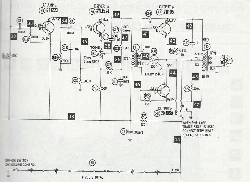

...the 780 has provision for using either NPN or PNP...
Please explain. -Thanks.
Unfortunately it's not quite as easy Sams would lead one to believe, only requiring jumper swap. The ones I've observed have soldered connections, still swapping ground & B+ connections isn't rocket science. Parts info lists three different alternate output transistors, one being PNP.

CaveRat, you wrote about putting a resistor in the emitter to prevent excesive currents due to replacing Ge transitors with Si ones...
Second it will reduce the overall gain slightly. This prevents self oscillation which is sometimes an issue.
That's what bypass capacitors are for..... To preserve the original gain value of the stage when there is no such resistor at emitter...
The minimun capacitor value should be one whose impedance is a tenth of Re at the minimun desired frecuency.
( Xc<<Re at min desired Freq)
or C=10/(6.28* f *Re) ;where f =freq min desired, Re =Resistor at emitter

How about the replacement for the originally listed germanium PNP output transistors? The radio's schematic diagram shows two transistors with GE proprietary part numbers 4JX1E850 and 4JX1E850A. Their specifications could not be found but the 2N1059 basic specifications could be used as a guide for finding substitutes.
Using GE's replacement guide, 4JX1E850(no listing for A version) crosses to a GE-8. Apparently used in P-780G, probably others. The '82 RCA SK manual calls for SK3862/103, with 103 being the ECG replacement. I see no reason the more robust SK-3004 would not be fine. Of course doesn't hurt that I found a couple of those in my stock.

I have a bad NPN output transistor in my P-780A, so I am going to try the silicon modification. I have quite a few NPN transistors on hand, with a little heat sink attached; will start with a 200 ohm resistor in series with a diode, for bias.
 Post subject: Re: Chasing Distortion GE P-780B
PostPosted: May Tue 24, 2022 11:13 pm
Posts: 11684
A series resistor of 240 ohms seems to be the best compromise between current draw and distortion. The output signal is very clean, until I start to drive it below about 50 Hz, probably due to transformer losses. Resting current is about 40 ma; I kept the original 4.7 ohm emitter resistor. The next thing will be finding replacements for the dial bulbs.

I suspect you've seen this, copied from a P-780H, what's in my 780A. H uses PNP xistors, I retained the NPN. Beginning with late B, I'm 99.9% all versions used PNP.
I'm extremely pleased. Best I remember, idle current less than 20ma. My notes are up in bell tower & I'm still sore from two hernia operations. I'll recheck first chance I get.
EDIT
Rather than go ladder climbing, I pulled out a Simpson 461 meter I have here in house. With fresh battery, operating at 9.3v, idle current is 12ma. Normal volume is approx 20 ma and loud, can easily bump 50 ma.

With the transistors I used, if the current is reduced, I started to get crossover distortion on low frequencies at high volume. It idles at 40 ma, and goes much higher at high volume. For outputs, I used small silicon power transistors, with a beta of 216. I kept the original bias resistors on the output transistors.

Success! Tom, I took your lead and replaced the outputs with a pair of SK-3010 transistors that I found in my stash, converting the bias circuit back to original. The resting current came back down to about 18 ma, bouncing up to about 55 on the peaks at high volume. Evidently, the silicon subs that I used were too "hot".

In addition to gain, I suspect there are other matching considerations. The 2SC971 I installed are matched pairs, no hint of distortion. No idea of gain as at time I didn't have a tester that I trusted. Pinned scale on the germanium testers I have.
Check this out, I suspect crossover voltage is as, if not more important than matching gain.

From the way that the output stage behaved with bias adjustments, I had a feeling that it was turning into class A operation; it kept demanding more current as I tried to reduce the distortion. I was up to 500 ohms on the series resistor, and it still wasn't enough; by that time, the resting current was up to about 80 ma. At that point, I realized things were going in the wrong direction.
It sounds MUCH better with the SK-3010s. I did try to match the gain closely with the silicon subs, so that wasn't the problem.

I wonder if separating emitters and using a 10 ohm resistor on one with a 15/20 ohm pot on other could compensate for mismatch?
