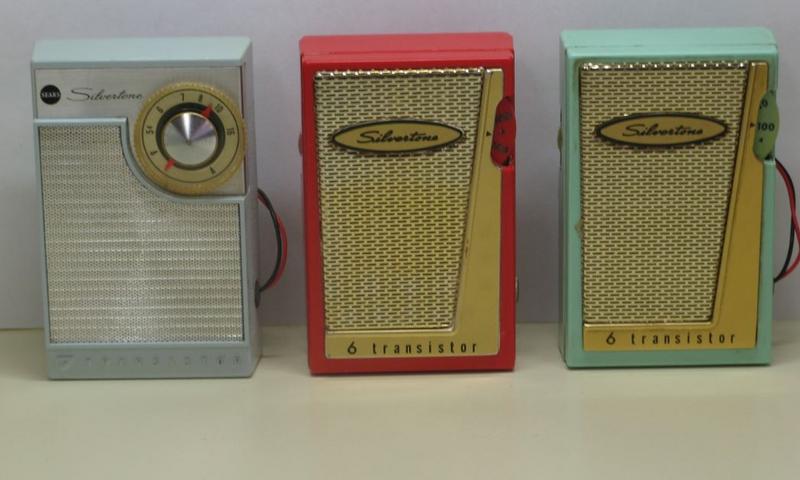

John, I did some research on my Silvertone vs the Arvins and except for one major difference, are mostly same. The Silvertone has a seventh transistor as AF amp. The RF, driver & output sections are nearly identical.

John, I don't have one of the Arvins but I do have six transistor Silvertone 2203 and 2204(also is model 2202) that I'm 99% chassis is same as your 61R19. The 1961 versions(1202, 1203 & 1204) of these radios used rectangular battery while the '62 I have use round.
You do have me wondering if a difference will really be noticable.
I have five, six, & seven transistor versions of the GE lunchboxes, all with three transistor RF. Main difference is better audio quality, stronger bass and somewhat louder volume before distortion sets in. Especially noticable in the seven TR version that has both AF amp & driver. These sets have 4" speakers but with the 2.5" speakers of the shirt pockets, would it be noticable? I did briefly try the 3209 and it seems OK, but I dunno if either of the other two are up for the test.
 Post subject: Re: Arvin 61R19,29 project...
PostPosted: Feb Sat 02, 2019 5:11 pm
Posts: 13599
After posting last night I opened the 2203(mint green) & 2204(red), same chassis as in the Arvins. I used the Arvin schematic and circuit board pictorial for test point location. Yeah that's right, 2203 dead & 2204 weak. Found speaker coupling cap all but open on 2204, hit the RF trimmer and buttoned it up. When I opened the 2203 I got a big surprise, :shock: it was missing the coupling cap between volume cont and audio amp. I looked closely at PCB, solder appeared orig. Still I'm thinking I opened it in past and pulled cap, I've been known to tap solder lands and extract parts as if I was pulling a tooth. Anyway I removed old solder, installed new 10mfd and it sprang to life(I'd already bridged cap in openings of missing part). Another RF tweak and back together. At that point I expired.
This morning I fed wiring for std 9v connector through earphone openings of 2203 & 3209. Since I only had two battery connectors I chose the 2203 as it no doubt has the edge on the 2204(yes I should fully recap these radios). As far as reception, the seven transistor 3209 isn't quite as sensitive as 2203 but extra transistor does improve audio. Possibly RF touch up would increase it's sensitivity. Where the 3209 really shines is it's vernier tuning, far easier to pinpoint stations.
Now that I've thoroughly muddied John' thread, here's something that may help. I also noticed tuning range seemed to be over extended, as I was receiving 1650 on both 2203 & 2204. When I looked at specs for 61R19, says upper osc setting is 1670. WOW. Was Arvin prepping for expanded band? :wink: Osc alignment for 3209 specs 1640.
