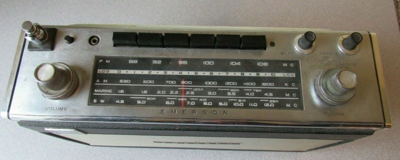

Looks like My recent purchase on the internals but made in Japan. Spooky
I wonder why two Transformers? One being a choke?
Mine is an Emerson Model 31P51.
4 band 6 inch speaker 12 transistor-8 diode. It's a performer with Volume w/ base and treble controls 4 watt speaker 5 ohms, 5 D cells.
9 pounds. Car adapter. Nothing on Schematics or even advertisements. Sold around 1967.
Is it possible even then, that a lot of those radios were being produced by Japan with European Name tags?
