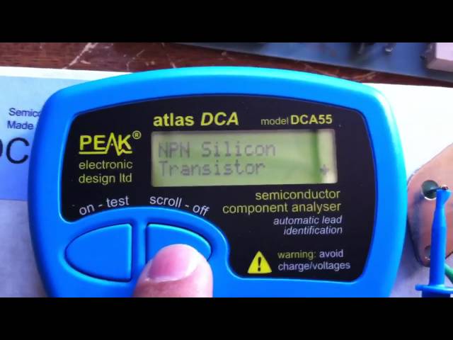

For oddball components, I use one of these.
"ten-dollar" component testers can be found on ebay.
https://www.ebay.com/sch/i.html?_from=R ... 6&_udhi=15
