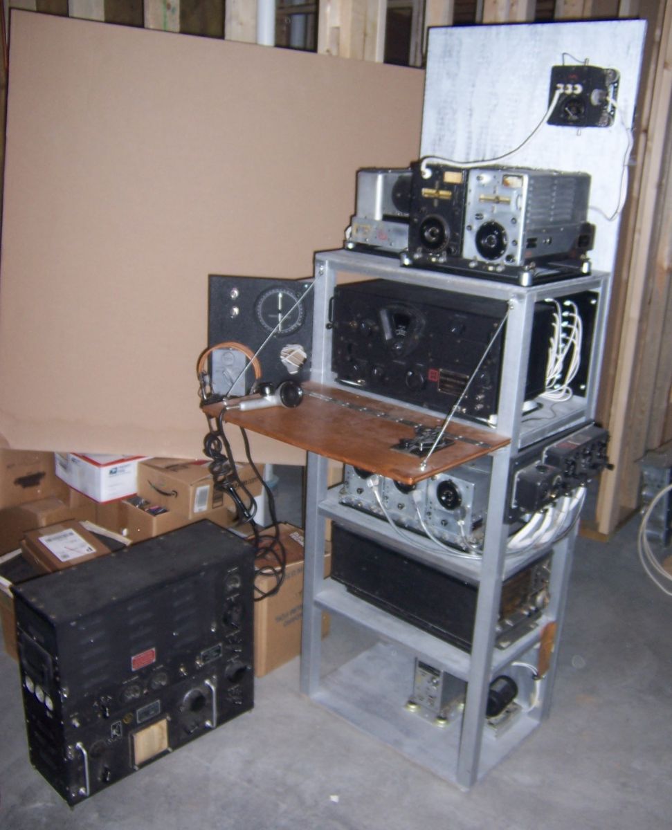

Here's an older photo of my mock B-26 radio shelves with an SCR-274N setup:
Sean
WØKPX

The transmitters and receivers plugged into mounting racks that had a mating connector. These racks came in single, double, triple, and even quadruple bay units. The receiver and transmitter racks were different from each other so receivers would be in one rack and transmitters in another. These racks then snapped into shock mounts that were riveted to the aircraft. The modulator and antenna relay snapped into shock mounts as well. The modulator, antenna relay, control boxes, receiver rack, and transmitter rack were connected together via multi-pin circular connectors.
The receivers were remotely tuned by a "coffee grinder" crank on the receiver control box. A Bowden (or speedometer type) cable is used to connect the control to the receiver for the tuning. The transmitters were set to a frequency then locked. Keying and selection of the transmitters was accomplished with a small control box. Typically these control boxes were located in the cockpit for the pilot to use as these were mainly for plane-to-plane or short range communication.
The BC-456 would use a DM-33 dynamotor that supplies 575VDC. It is a larger dynamotor, almost twice the size of the one you have (which should be labeled on the bottom of the mounting plate as DM-32, DY-2/ARR-2, CBY-21531, or CCT-21531).
The contract number won't really tell a whole lot, unless you have access to Western Electric company records from that time. The SC on both units probably indicates they were actually built by Stromberg Carlson. I know they built a number of the ARA/ATA and ARC-5 components. The CCT on the transmitter nameplate is the manufacturer code for Stromberg Carlson. If you find something with CBY on it that was Aircraft Radio Corporation who actually designed the system.
With these being Navy units they would have been destined for Navy aircraft. Whether they were actually installed in an aircraft and what specific aircraft would be nearly impossible to find out. There were many of these units built that were sold surplus after the war still in factory sealed boxes having never been used. Every once in a while one will still show up for sale. About the only way you would be able to find out if it was installed in an aircraft is if someone had made a note somewhere on the unit with an aircraft number. I have a couple pieces of AAF equipment and manuals where someone had written the serial number of the aircraft to which the item belonged. That serial number can be looked up and some of the history of that aircraft can be gleaned.
