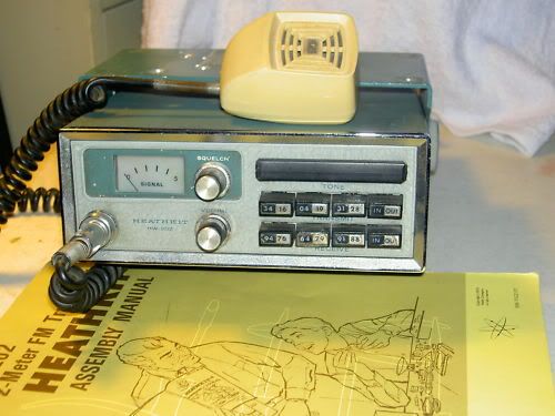

I have to start out by saying, I don't know anything about "ham" radios...I live in Florida and have been through a couple of bad storms...so I actually went looking for an old radio I could use in case of an emergency.
This is what I found:
I thought it was a CB at first, but a "Ham" told me that while it could be set up as a mobile unit - it would work better for my purposes as a base unit - he then told me I'd need a power supply, and for an emergency set-up he suggested I invest in a tube tester, and that I also have both an AC power supply as well as a DC/baterry back-up...but that's all I was able to get out of him.

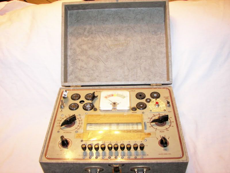

I JUST got this old Heathkit Dynamic Tube Tester:

I've nosed around a little and found that the AC power supply this unit requires is a "HWA-202-1" (and I'm looking for one on eBay), but I have NO IDEA as to what DC/12 volt option - nor do I know what else I will need to complete this project!
I would certainly appreciate any help you experts could offer - I've reached the end of the rope and I'm only still hanging on because I found this knot at the end....!
HELP!!

The HW202 runs off of an automotive 12vdc ( actually more like 13.8 vdc) power supply. Any power supply with about the right output voltage and sufficient current will operate the HW202, you don't need the matching supply.
Problem is you do need an amateur radio license to talk on that radio. You can listen without a license
Even if you use it to listen, that radio needs a different crystal for every receive channel. The crystals that are already installed might not be for the channels currently used in your area.
You would be better off attempting to sell the HW202 on Ebay for a few bucks- it is not worth a lot- and put that money into a standard scanning radio.

You do realize that Heathkit radio has nothing to do with tubes, right? I think you do, but thought I would mention it.
By the time you get through finding a place to make you crystals, they will cost about $ 15-20 each and then you will need a frequency counter to zero them in. Four channels' worth of crystals will be more than a brand new rig like an Alinco or a Puxing type 2 Meter radio costs, and those can also be used to scan emergency services channels for some agencies. And, as above, if the Heath doesn't have tone squelch, you will be unable to access most or all local ham systems. Unless the crystals in the Heathkit already match everything you would want to use in your local area, and haven't drifted out of tolerance with age, you would be throwing money away trying to rejuvenate a forty year old radio.

Just for the record, Heath made a matching AC supply HWA-202-1 for it. I built both units, which are still sitting in the garage. I see that this one was set up for the popular 34/94 repeater frequencies.

You really don't need the AC power supply to power it up. Just plug it into the 12VDC supply in your car. Or hook it up to a spare car battery if you have one.

Since nobody has told you, the Heath HP-13 is a 12 Volt to 800 Volt DC to DC converter used with their 1960's tube type HF ham gear. It has nothing at all to do with this model and can not possibly be used with it. This radio operates from 12 Volts already, it doesn't need a mobile power supply.
If you tried to connect the HP13 to this radio, you will just end up destroying both items.
