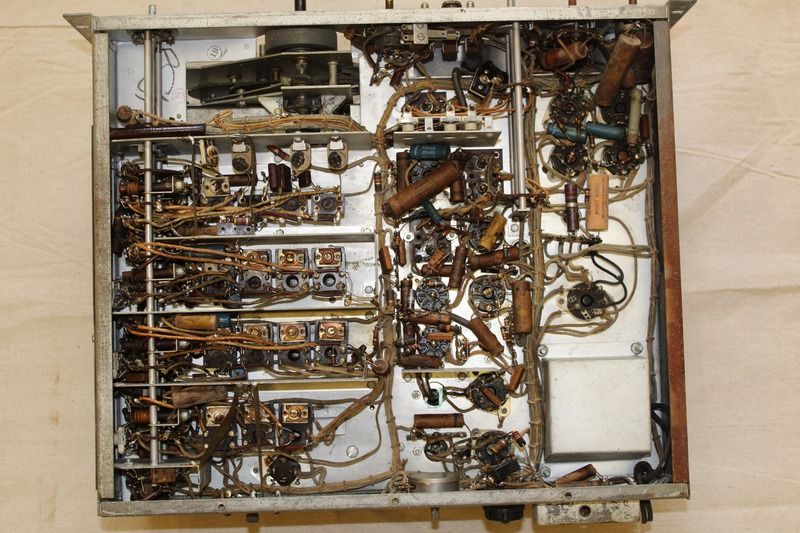

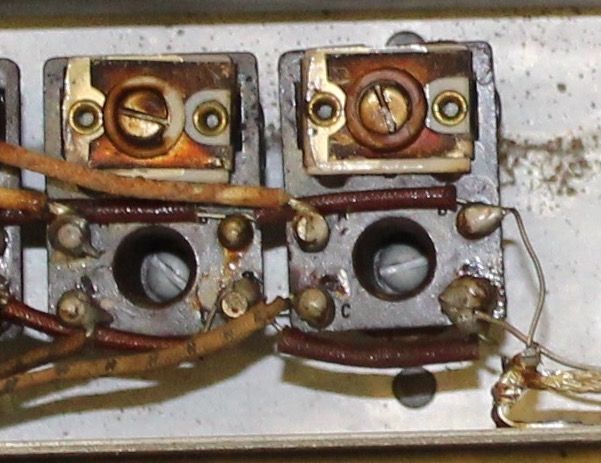

As my grandchildren sometimes like to say, "Silly Papa!" If any of you folks with SX-42 experience read my last post, you were probably thinking something like that as well.
I spent most of the next day removing 4 capacitors, after an hour or so of reconciling my daily notes of components removed or checked. Checking against the parts list in the November 1947 94X242 Service bulletin, I discovered there were two more paper caps buried under the RF amps besides C11 and C25 which I had earlier identified.
The two I hadn't noticed before looked like large mica caps as you'll see below in the Nastiest Caps photo. These are C12 and C26 in the schematic.
Here's a shout of the location of these four caps.
Somewhere in all this identifying of components I made a happy discovery: one can gain some access to the inside leads of C11 and C25 from the top of the chassis. Using this new access, I was able to actually cut the inside leads fairly close to the cap rather than the twisting earlier planned that might have brought collateral damage to the tightly-packed area.
Still having the SX-42 lashed into the Steve Strong chassis stand, I was able to remove three of the 4 "Nasty" caps - all but C25. For this one, the end gusset or panel of the chassis had to come off, and for that the receiver had to come out of the chassis stand. :(
As often is the case (for me) the dread of doing was worse than the doing, especially as my youngest grandson was available to lift one end of things in the process.
As you can see in the picture below, there is much greater access to the bowels of the RF deck with the end panel/gusset removed. Given this better access, I was fairly easily able to check most of the critical resistors in that area and found several warranting replacement.
That and installing the four "Nasty Cap" replacements is today's project. I wanted to give you this update in case I don't survive, as putting the cap's back in looks to be at least as challenging as safely getting them out. I'll be implementing some of the creative suggestions for "custom" soldering guns/irons given here.
As I think Wilford Brimly used to say, "Thank you for your support."

Chuck,
I ended up removing the metal brackets with the trimmers attached to get at C11 and C25. It made it easier. For the first SX 42, I did not remove these trimmers and it was rather a PIT, and I was worried I might have a short where I couldn't see the entire lead.
Norm

Thanks Norm. When C25 would not come out the side past that bracket the other day, I had tried what you suggest but the bracket was too restricted by its heavy connecting leads. The only way I could get the caps out, once cut free of their leads, was to take them out past their respective RF coils towards the center of the chassis. C25 even then could only be gotten out by clipping one end of R8 and R11 to allow it past them. Luckily both of these resistors were significantly out of tolerance and needed to be replaced anyway and I hadn't done that yet.
********** BULLETIN - BULLETIN *******
As of 1445 CDST according to the official log, the four "NASTY CAPS" have been safely replaced!! :D :D :D
Here's a shot of them resting comfortably in their new surroundings:
Now, just a few more resistors, a new line cord and fuse holder, testing the tubes, and I hope to be easing power to it later this week. For now, the next couple days will be devoted to a short trip for my honey's 70th birthday.
73, de Chuck K4CCW

A little tracing revealed that the antenna coil, T5, primary was open. The good news is that I could see (with magnifying headset) the tiny lead dangling near terminal D of T5 and it looked like all I had to do was reconnect it. The bad news is that it turned out to be the terminal end, not the winding end. :( :(
I'm back here to ask if anyone knows how to access the winding on these RF transformers? Each bank is mounted to a metal strip at the chassis that is in turn riveted to the chassis.
I hope there's something I'm overlooking, as I don't see a way to fix this winding without removing the transformer.
Color me stymied.
73, de Chuck K4CCW

I would suggest you remove the transformer, carefully unwind the turns of the primary--counting them as you go, and then rewind with new magnet wire of the same approximate gauge. The exact number of turn is probably not critical as that side is not tuned. I don't remember if the primary is the upper or lower coil on the form --or if it is wound on top of or underneath the secondary. You may need to re-wind both.
An alternate route would be to abandon T5--create a new T5 and add it in where you have the space running leads to the existing connection locations. My BC band on the SX 42 I am doing now has very low sensitivity. It doesn't use the first RF amp stage. I have been struggling with it for some time. I am about ready to abandon the first two transformers, wind my own and create my own tuned circuits for that part of the chain. If I didn't have another SX 42 that works fine, I would say it is just bad design.

Hi Norm,
I'm familiar with the procedure you outline, once I have the transformer in my hot little hands.
It's the HOW of removing it that I can't figure out so far.
One thought I did have is that I could just forget about the broadcast band, since that's all T5 serves.
If anyone has copies of the band-by-band schematics, I could sure use them for the first three bands. Somewhere along the line I acquired part of them, the top 3 bands, but not the lower three.
BTW, Norm, I'll keep your latter ideas in my back pocket as well. Thanks for weighing in.
73, de Chuck K4CCW

When you look into the coil form from above, isn't there a screw that is threaded into the bar below, holding the form in place?
Norm
