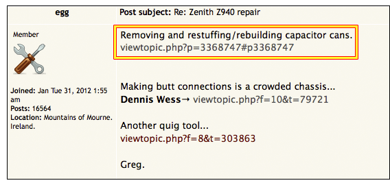

This link on page one should show you all that you need to know about replacing filter capacitors.
If and when I restuff a can, I drill a 3/16" hole in the center of the base and bring the insulated wires through / into the chassis and disregard the old solder tabs.
Insulate all leads inside the can.
and... if you've got OCD, you can line the inside of the can with a washed piece of plastic cut from a plastic "bottle"
HDPE – high density polyethylene. lol
