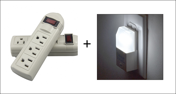

For those of you without a shop's Big-switch...
Plugging your soldering iron into a three way along with a kids night-light ensures you remember to switch it off when leaving the shop.
just tape over the sensor.
