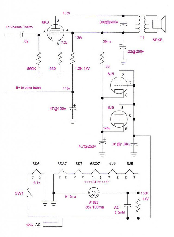

I want to replace this 25ohm resistor with a capacitor because I have a 5 watt resistor in there but it still gets to hot for my liking. I can’t figure out what size it needs to be.

Start over, you asked about the 25 ohm not the whole cord.
It's really not practical to replace the 25 ohm with a cap because the cap would have to be a very large value.
You can remove the pilot lamp from the filament string and drive it with a 5uF, 250VAC cap directly from the AC power.
I'll add a schematic.
Are you using an 8uF capacitor to replace the resistor power cord?

Sorry I screwed up also it is this 86 ohm resistor. I put the wrong radio schematic up. I am working on two different radios at the same time.

If you are using a 35L6, then the cap should be 7.5uF, 250VAC rated to replace the 86 ohm resistor.
If you are using a 50L6, the resistor should be removed.
Jay

7.5 uFd 60 Hz with a current of 0.15 amp flowing through it will have a voltage drop of
(1/377 * 7.5 E-6) 0.15 = 354 volts.
The tubes will have a drop of 35, 35, 12.6 12.6 12.6 = 107.8
Adding by pythag means it will take 370 volts AC just to light the filaments.
Tell me my calcs are wrong! :D

Tube string resistance is 107.8V / 0.15A = 718.7 ohms
Total impedance needed is 120V / 0.15A = 800 ohms
Since the we are adding capacitive reactance and resistance, we need to compute the other leg of the triangle.
Square root of ((800 x 800) - (718.7 x 718.7)) = 351.4 ohms capacitive reactance
Capacitor value is 1 / (377 x 351.4) = 7.55uF
I think you will find the above is the correct way to calculate the impedance of a resistor and capacitor in series but I am getting old and make mistakes.

Yes!
108 volts for tubes @.15 amps = 720 ohms
7.5 uFd @ 60 Hz = 353 ohms
SQR 720 ^2 + 353 ^ 2 = 802 ohms
120 volts / 802 ohms = 0.15 Amps
What voltage across capacitor ?

This is the result of running the circuit analysis software called Micro Cap.
Circuit:
Voltages and current:
The cap and resistor voltages are not in phase so they do not add directly. The resistor voltage is about 152V peak or 107.5VRMS.
The cap voltage is about 75V peak or 53VRMS.
The current has to be the same in both the cap and resistor since they are in series. The current is about 149mARMS.
Jay

One of the big advantages of using the cap for the voltage drop is that the filament currents during tube warm up are lower than with a resistor.
The tube filaments will be about 100 ohms when they are cold. With the 86 ohm resistor, the initial current through the filaments will be about 650 mA.
With the 7.5uF cap instead of the resistor, the initial current will be about 325 mA or half as much as with the resistor. Warm up time is longer but the tubes and pilot lamp will have much longer life.
Because I'd done some consulting work that fluorescent lamps in the past, I had needed to find a workable SPICE model for filaments that included the time constants and cold resistance. I was able to model the filaments for those lamps and applied that to this problem and ran a comparison of the 86 ohm and 7.5uF capacitor dropper with this circuit in LTspice:
The .param statements define the filament characteristics and were chosen to give an inrush current of about 10 times the rated current (1.5A) at 107.8 volts. This is usually a good figure for Tungsten filaments. The time constants were chosen so the current would drop to about 150mA in 10 - 15 seconds. Below is the result of the comparison:
The yellow trace is with the resistor dropper and the green is with the capacitor. You can see proof of what Jay said about the cap lowering the inrush current. The schematic shows the current for the first second and the last 5 seconds of the simulation.

Thanks for the program url, i might try something to further look into the heater cathode
voltage issue. The only other suggestion is a discharge resistor across capacitor. Just in case
the capacitor retained a charge if the plug prongs were touched by someone unplugging the
radio, then picking it up. 470 K would do.

The cap discharge resistor is a good idea. 7 or 8uF charged to over 100V would not feel good. If the radio was in operation, the rectifier current would discharge the cap to a fairly low voltage. However, plugging and unplugging before the rectifier got hot could definitely leave a high voltage on the cap.
I think 100K would be a better value for the discharge. That would get the voltage to a safe level in about 1 second. 470K would take about 5 seconds and it would be easy to touch the plug in that much time. At 100K, a 1/2 watt resistor would be OK.
I have looked at the surge current with the cap but it is so short that it shouldn't be a concern.
This isn't near as bad as the situation of charging an electrolytic without a surge limiting circuit. That can ruin switch contacts in a few cycles. The tube filaments have enough resistance even when cold to limit the peak current to the 1 amp area.
