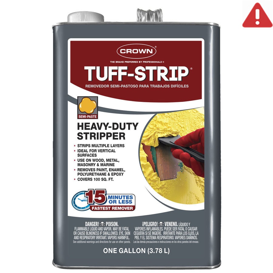

I use this stuff; won't harm the wood, and it begins working immediately;

I like Jasco paint and epoxy stripper. Get some real chemical gloves from the hardware store. Get some coarse steel wool and a wire toothbrush too. Have a couple of putty knives, one stiff and one flexible. Coat the bottom or other less visible part and get a sense of how well the stripper is working. Scrape the bulk off with the putty knife that works best, re-coat and use the steel wool. the Once you have a handle on it go nuts. The toothbrush is good for getting it out of the grain and cracks. Be careful though, you can remove more than you want to. Good luck

Removing the paint will remove the original finish. There is no practical way to get around that.
If there is only a single layer of paint, the type of stripper isn't really critical. Methyl chloride strippers will work slightly quicker, but overall not a big difference.
Skip putty knives and steel wool. It is much easier and quicker to use hamster bedding as it's slightly abrasive and it absorbs the spent remover and sludge it creates.
