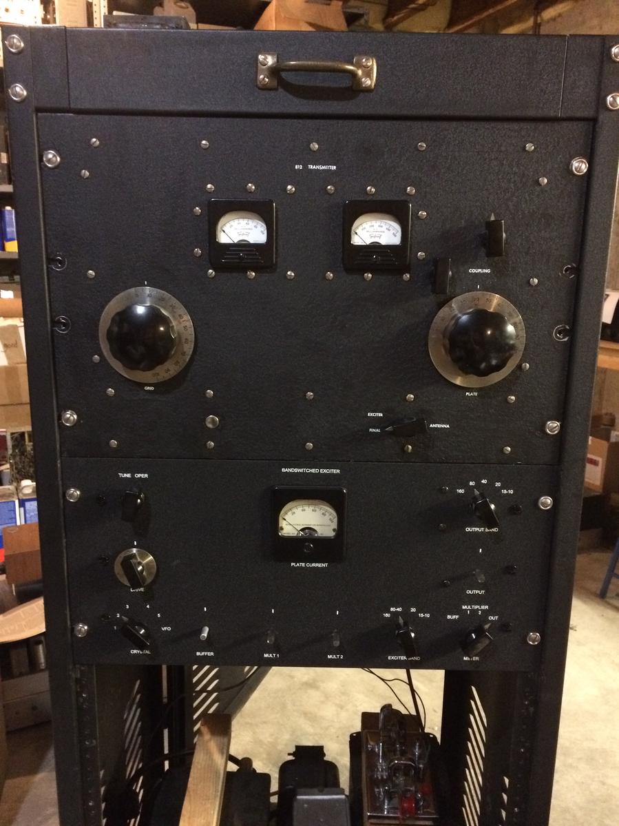

I made some white water-slide decals for the exciter I built for my 1950s vintage 812x811 transmitter. I used a method that was outlined here on the forums. I printed the lettering onto decal paper with an ink-jet printer then sprinkled white embossing powder I bought at the craft store over the wet ink. When the ink has set, gently tap the decal paper edgewise on a surface to remove the loose powder that did not stick to the letters. A heat gun is then used to melt the powder and fuse it together.
Here's the ARF thread:
https://www.antiqueradios.com/forums/viewtopic.php?f=7&t=54791
Here's a photo of the exciter with the original 812 PA above it. This method does give a little bit of a 3D effect to the lettering but it isn't noticeable unless you get up close.
Sean
