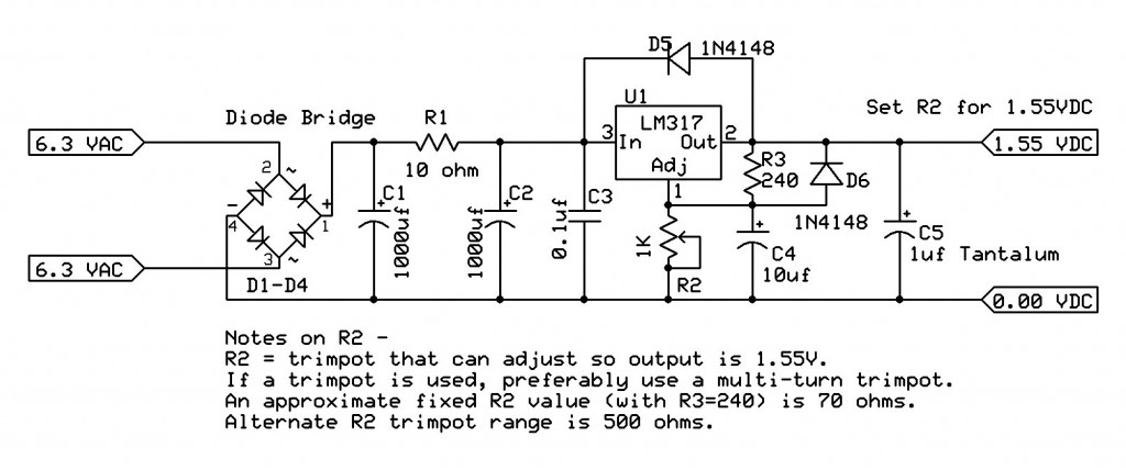

I re-did an older version of the Heath VTVM.
--replaced the selenium rectifier with a 1N4007 silicon diode
--filter caps should be replaced and I used 250 V caps instead of the 150V originals
--I built a battery eliminator from an LM317 voltage regulator. This uses the filament voltage as a source to power the OHMs ranges. Similar to this one:
--Probably good to replace the series AC blocking cap with a modern film type capacitor
http://s117.photobucket.com/user/radioc ... 2.jpg.html

Most VTVM's that I have seen have one side of the tube filament circuit grounded. Also, one side of the Ohms measurement battery grounded. Both these observations are true for the IM-13. This requires use of a half wave rectifier in the low voltage power supply circuit, with a larger filter capacitor.
-Chuck
 Post subject: Re: Heath VTVM IM-13 resto
PostPosted: Sep Sun 11, 2016 2:13 am
Posts: 3731
Location: Littleton, MA
Unlike the IM-11, the IM-13 doesn't use a printed circuit board. It is point-to-point wired. So it is easy to lift the ground on the filament circuit, thus enabling use of the full wave bridge rectifier.
I do wonder what subtle consequences might arise from lifting that ground. The filaments will then be grounded through the rectifier, alternating the side that is grounded at 60 Hz. I don't understand why the filament circuit needed to be grounded in the first place.
Steve Byan http://www.byan-roper.org/steve/steve-at-play/

12 parts to replace a battery? Seems like more parts than there are in the whole VTVM, once you get past the range switch! The last generation of VTVMs like the B&K 177 which had power supplies for their Ohms ranges simply took a half wave silicon diode from the 6.3-volt heater source to a 1,500-uF filter cap (the negative end of which is grounded) and put a 16 ohm, 2-W resistor in series to drop the necessary voltage. Three parts total, and no need to lift any grounds or modify the VTVM circuit in any way. One might have to use something a little higher than 16 ohms when doing a retrofit into a meter that originally had a battery.
The tube filaments are grounded for a simple reason. The cathodes of the 12AU7 are operated at -60 to -85 VDC. Consequently a DC charge could develop on the heater circuit via the leakage of the heater-cathode insulation. That wouldn't really hurt anything as far as the 12AU7 is concerned, but the 6AL5 operates at very low voltages, and if that -60 to -80 VDC gets onto its ungrounded cathode through its heater-cathode leakage, it will pretty much be the end of AC voltage measurements. Grounding one side of the filament circuit gets rid of the leakage and prevents the problem from happening.

Come to think of it, I did use a half wave rectifier circuit.
The goal was not to re-design the VTVM, but rather to simply replace a 1.5 V battery. Most folks leave batteries in VTVMs for years; they leak chemicals.

.....The last generation of VTVMs like the B&K 177 which had power supplies for their Ohms ranges simply took a half wave silicon diode from the 6.3-volt heater source to a 1,500-uF filter cap (the negative end of which is grounded) and put a 16 ohm, 2-W resistor in series to drop the necessary voltage. .....
The I77's I've seen used the rectifier circuit and a voltage divider consisting of 36 and 12.7 Ohm resistors, with the 12.7 in the bottom of the resistance-standard tree. This gives about 1.5 volts at a source resistance of about 9.4 Ohms, which combined with lead and contact resistance, is right for the low-range center scale of 10 Ohms. The disadvantage of this circuit as opposed to the LM317 circuits is that it puts a continuous load of about 129 ma on the transformer with the probes open and about 175 when shorted. B&K would have sized their transformer for this, but it would be an additional load for other makes. I've used similar circuits without problems but it is a consideration.
I've also used the half-wave 317 circuits and they work well. I wondered about transformer loading and monitored the filament voltage when the probes were shorted. The variation was a few millivolts from open to shorted. This was with both EICO and Knight VTVMs.

Is there any reason why the battery eliminator couldn’t be taken off the B+ supply? Through a diode/resistive divider feeding the regulator chip. Negligible load on anything that way just a few extra parts?
