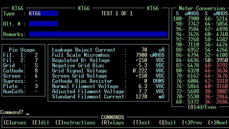

I just made a small utility program for converting Cardmatic test card into pin mapping data.
Program screen shot as attached.
I just started this project yesterday, functionality is limited.
Any one would like to give it a try? Also let me know what you think, we can put in all the function we want, if that is do-able.
Please leave me message for email address, so that I can send you the program for testing.

Alan, what I intend to do is to convert scanned image into binary mapping data. This program is not that smart yet, you have to click on the lower left "hole" (A-17) and drag mouse all the way to upper right (L-1), then it generates grid, calculate and judge each intersection being a "hole" nor not.
My next step is to eliminate this TWO-CORNER locating, let program do the image processing/judging itself.
With this pin mapping ( 17 * 11 = 187 Boolean value matrix ), thousands of records is just a small table. Computer program can easily re-create a card image, clear and perfect. Maybe there is a kind of printer that can print the "hole" or "non-hole" on blank card, you can then punch it.
(Or there is a kind of computer controlled punching machine...well, this has gone too far, just my day dreaming, too expensive....)
The whole point is an easy way to
1. append/edit/validate card information, we can even put this on a cloud server so that we all can get access to it.
2. easy to find the record you want, if you need to "punch" a card yourself
3. people can exchange and share their database easily. We can create our own database and merge database from others and expand the whole set. Well, if there is this kind of database already, then ignore my propose, we can just get it with or without some cost.
4. with the pin-mapping, program will be able to parse the meaning of these cards, filament voltage, Ef, Ec..Gm or Ib and so on, according to the description in the technical manual and other information available online. This would provide you another way of looking up the "Tube Test Condition Table".
5. computer aided design, you can even design your own special test card with this kind of data. I don't really know about tube or electronic circuit, I can not say much about this.
6. other application...people can always figure out different application or improvement on this kind of database, once the database is available.
7. as for commercial value, sorry, I did not think of that. This is my hobby, not my job. I am willing to share the program and database (not now, program is still under construction, database is to be defined). It is to build a database and a set of application programs. I can not do this all alone. I can not scan and process thousands of cards all by myself. It takes us to do it together. And I do this just for fun.

This program is a prototype. It works for Hickok card format, 11 * 17. it works with 121, 123, too
Currently it just processes the image and generate a 11 * 17 Boolean matrix, I am still thinking what the output format it will be and what other contain is to put in.
To build a database and its application program, we have to figure out what we want to do with these records.
1. Tester Model Type
2. Tube #/ID
3. for the technical meaning, Ef, Ec and so on, it depends on what kind of information we can get. I have only read part of the spec for KS-15874. At least, for the part that I have read, it should be able to parse the values from the pin mapping. I guess it applies to other model of the same style. As for 123 or 121, I have no information in hand.
I am still working on this image processing. I have downloaded some low-resolution card image and I am testing it. Lower resolution >> Less Information >> Higher Noice >> you know........

Just a FYI, most of what you are trying to accomplish has already been done by my Computerized Cardmatic software. It has 3,924 cards in it, and the software provides on-screen data showing the test conditions for each test. Here's a sample screen shot:
I am currently working on a way to make this data available on the web. My plan is to make all the cards available as a download for a small fee since in my case this isn't just a hobby :).
-Phil Frakes

Phil, that is a nice software!!
You know, I am kind of "lazy", when I read the instruction manual, describing the meaning of pins, I just think that, hey! if I have the data of pins then I can parse the testing condition, pin assignment and so on........
And use a scanned image would be not too much work to do to build up a library.
Well, kind of fun thing to do.
