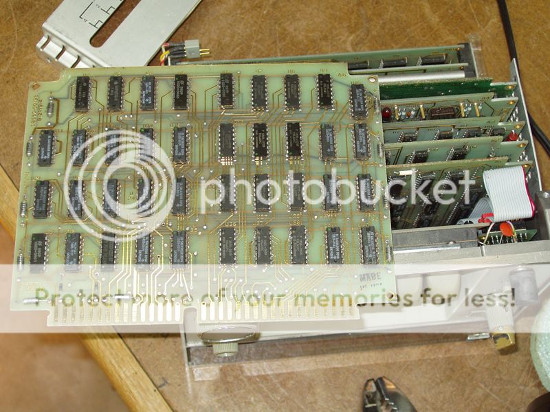

DO NOT run that with out the fan. The control head is FULL of 54/74 series TTL devices and the heat will ramp up pretty quickly.
This is my spare parts control head.
I believe the 8660 is a "state" machine in that the functions are handled by discrete logic elements, configured into various "states" by the front panel controls, and there is no microprocessor control. I think it was one of HPs last non-microprocessor signal generator.

Wow, that looks like a nightmare to troubleshoot without an extender cable.

The four pin power connector to the digital control unit (DCU) is notoriously intermittent. Put a slight bend in each of the four pins to guarantee a solid connection.
Fans are not expensive and the 8660's MUST have one.
You do not need any special cable to troubleshoot the DCU; all you need is a piece of cardboard (insulator) on the top of the low 20-30 MHz section and, place the upside down DCU there, and reconnect the ribbon cables. You will need two extender boards, be sure that these extenders have independent sides with no thru holes.
The highest failure in the DCU is A1A4U10; I don't recall the failure mode even though I serviced at least 700 8660's as the factory service engineer but haven't touched one in 23 years.

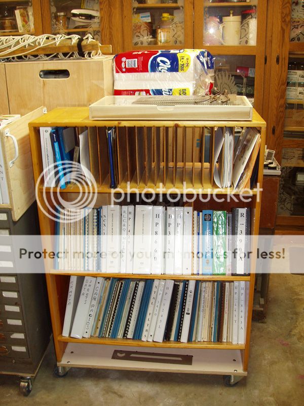

I buy original manuals for all my test gear, and HP is especially good documentation. You will find a trouble shooting chart in there somewhere, which will be very helpful. I consider their cost as part of the equipment price.
They take up a bit of room, but...
...the fold out schematics and drawings are invaluable.
