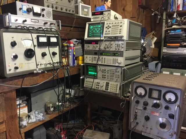

I just got a 606B and a 608C. It was a package deal and a good deal at that. Theres really no big use for the 608C your D is very similar......... It covers VHF and UHF and AM only. I got excited that I could align my Hallicrafters VHF stuff and then remembered its FM and the 608C will be of no use. Its cool and its a very neat piece of test gear but you will have very little need to use it. Its not possible to use it to align any of the "shortwave or Broadcast tube radios....The 606A or 606B is the unit you need!
I have modern equipment and the 606B and 608C. Here is a picture of them all together to show size.............The 606 and 608 are very big and heavy!
