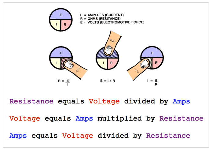

The other thing is knowing Ohms Law and the Power Equations. You can either remember all of these, or if you are ok with algebra simply know how to transform one equation into the others.
Ohms Law (all three versions)
E= I X R
R= E / I
I= E / R
Where E is the voltage (Volts) across an element (typically a resistor), I is the Current (Amps), R is the Resistance (Ohms).
Power Equation (all three versions)
P=E X I
P= I(squared) x R
P = E(squared)/R
Where P is power (Watts).
If you know these things you can always tell how much current is flowing through a circuit by simply measuring the voltage and resistance. You will also know if a resistor is being stressed by too much power by just measuring the voltage and either measuring or knowing the resistance. It helps if you know this stuff rather than always having to ask someone and never knowing how/if they gave you the right answer (what wattage resistor do I need for..., how much current is being used by this tube..., etc.).

Ohm's law.
Place your finger on the one that you want to find.
