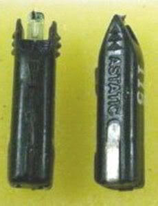

Now we get to my real question - - Since the concensus seems to be in favor of the 89T - - let me understand something...correct me if I'm wrong !
The best ones for my 45-EY-2 (this has the 3 tube amplifier) would be the original Power Point 89T ? What do they look like - how would I recognize one?
The next 89T was the Astatic 89T, which I gather was nearly as good as the Power Point original ? Are they the green ones in the picture below? What is their availablity ?
Finally, the ones I've seen on ebay and other places are often listed as Astatic, but are seem to be knock-offs called 911-d1, etc.
I have read here, about tan colored 89T's, but have not seen them.
So, finally.... which is best ?
I have already decided not to go with the low-rider drop-in cart that has been discussed so much here... I'd prefer the higher voltage (1v) output even at the expense of the easy ride. I want that pronounced bass that everyone seems to attribute to the higher voltage.
The red '89T' in the pic below is found on eBay ..... what's the story on it ? Evidently it's the only one commonly available now, but I don't want to invest in it, if it's just a cheap knock-off.

I've never had any experience with the newer red ones; but, I've heard that they sound like crap.
The double tipped gold ones were around in the '80's and continued to be made until recently. I've seen a few gold ones that were stamped "Astatic". Quality seems to be a toss up. I've had some that sounded fine while others didn't sound as good and would sometimes wreck the record grooves as it tracked.
I think the black Astatic originals were the best; but, quality can again be a toss up.
I think Astatic got out of the needle business sometime in the '80's; so, all of the 89T's made since then have been Astatic knock-offs.
About two years ago, I ordered some $5 "no name" 89T's that were housed in a shiny black shell and were very cheap looking. These did sound like crap and I won't make that mistake again.

PostPosted: May Wed 26, 2010 1:44 am
Posts: 14346
The gold ones have a diamond LP needle. The black ones are sapphire tips.

ok... so far... here's what I've seen and been told about these cartidges.
Gold - diamond tip
Black - sapphire tip
Red - bad quality .7 mil aka 911-D7
Blue - unknown quality
Tan - unknown quality
Green - unknow quality 911-S3 (for 78 only)
Some came with 78 tips on the opposite side, and are scarce now.
33/45 tips are 1 mil .... 78 tips are 3 mil
voltage is nominally 1v
aka: 911-D7, 911-DS77, 911-S3
I notice, for instance that the red one has a .7 mil tip while others claim to have a 1 mil tip. Am I reading this things wrong, is the information inaccurate or do these carts actually vary in tip size (Not including the 3 mil 78 version in this question).
If any of this is incorrect, please chime in.

Louie7 wrote:
...The next 89T was the Astatic 89T, which I gather was nearly as good as the Power Point original ?
The original was the Astatic 89T Sound-Flow. Electro-Voice makes the Power Point cartridges.
The original Astatic 89T has a 1-mil tip radius for microgroove records and a 3-mil tip for 78's. The cartridge is supposed to be stereo compatible. That means that it is compliant enough to be able to track a stereo recording without damaging the record. Later versions came with a 0.7-mil stereo tip on both sides and later still came the single tip versions.
These are designed to be disposable cartridges. Wear out one of the tips and replace the whole cartridge even though the ceramic element may still be good. Even the Astatic brand can be a real crap shoot. Older ones can be trash depending on how they have been stored.
Some of these new old stock cartridges are nearly a half century old. It shouldn’t be too surprising that they might be in less than perfect condition. I see them listed from $5 to $70 and wonder what the heck these sellers are thinking. They have no idea of the real condition of the cartridge or the value of the record player that it’s used in.
I have a sneaking suspicion that the newer Pfanstiehl 911-D7 cartridges may have much higher output than an original 89T, causing them to overload and distort on two stage amplifiers similar to the ones used in the RCA 45-EY-2 and EY-3. They may work just fine on the single tube kiddy players. Not to sound like a snob but I just don’t do one tube players so I’m not going to be the one to prove that theory.
