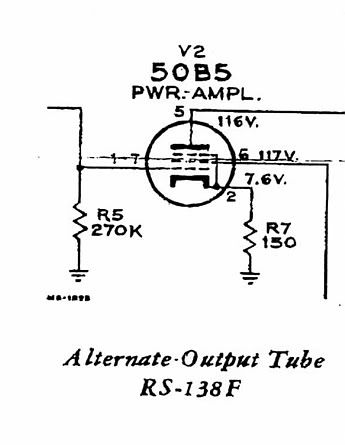

Sure... I'd like to do that mod. However, my circuit employs a different tube at that point. It's a 50B5...
Would you be so kind as to indicate the connection points for the 100/50 cap, in this illustration, which shows the 50B5 in a 45-EY-2
Thanks. L7

Louie, you simple install a 100uf cap positive side to pin #2 of the 50B5, negative to ground.... in other words, jumping across the cathode bias resistor. (R7)
A 25 volt rated cap is sufficient.

Seems simple enough.. .. .. thanks!
