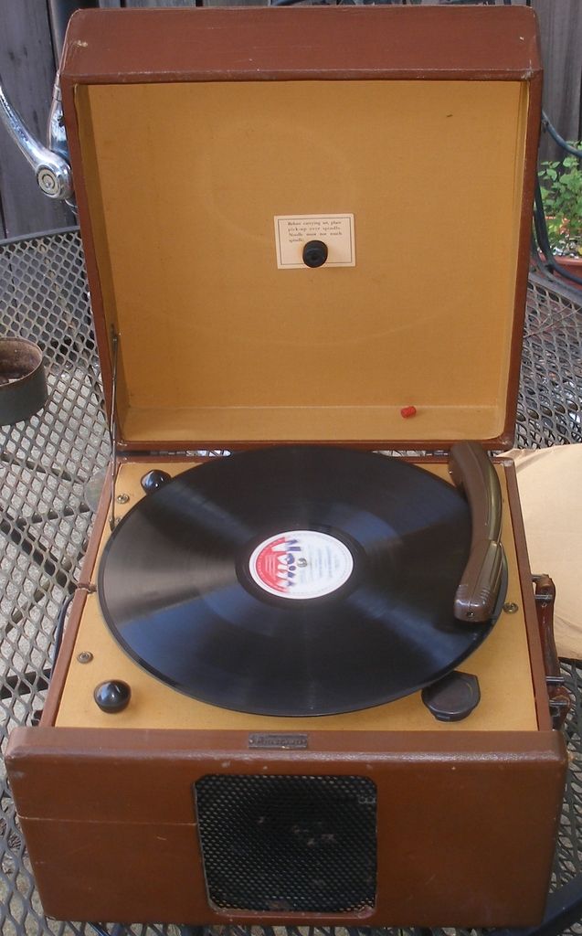

One that I recently serviced. Uses a 3-tube amp and 5" speaker. The original cartridge was a heavy tracking crystal and I replaced it with a powerpoint plug-in cartridge (now tracks at about 5 grams). The original Tenite grille had fallen apart and I replaced it with a metal grille from an old junker record player. This is a nice sounding 78 rpm player and with the lighter tracking tonearm, it will safely play a wider variety of 78's.
