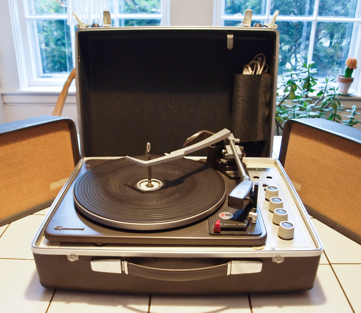

Can't talk vintage portable phonos without mentioning the KLH model eleven...in production from 1962 until about 1970. More high fidelity then any other suitcase portable I know of...Pickering cartridge, Garrard changer and acoustic suspension detachable speakers. Despite the small 4 inch driver size, frequency response was amazing - they had the greatest magnet weight to cone size ratio of any small speaker made in the 60s. Also of interest is that it was the Worlds first transistorized portable phonograph ! Since they were in production for some 8 years, they are can be found without too much trouble. Unlike many portables, some of which were bulky and heavy, the KLH was a breeze to travel with.
Are you talking about this model? I love at first sight. I hope I get one like this. Worst part is that I am in Toronto, Canada so shipping will be quite a bit but it will be worth with this player.

Yes...the photo above shows a early model eleven with the early tone arm & large head shell (1962-4), and the control knobs were also bigger then later models. They were also sold under the Singer label after 1964 when KLH was bought by Singer Corp. It does take a bit of searching to find a model eleven at a fair price, but they are out there. I wouldn't pay the high $ unless it has had some full service done to it..stylis, caps, idler wheel replacement, etc.
