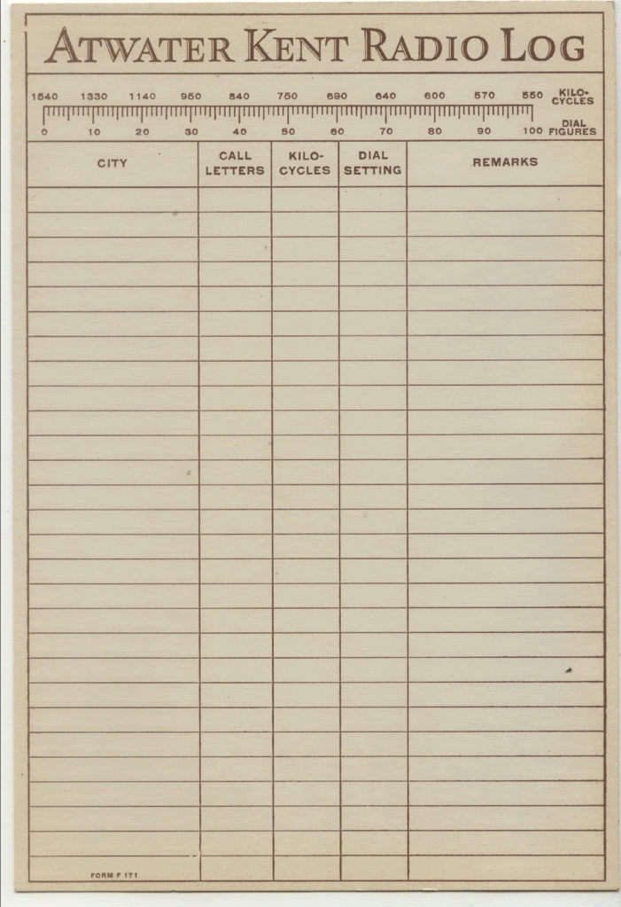

Does anyone have a scan or a link to a 0-100 log scale to modern KHz ? Thanks

No such thing, really. Every tuning capacitor would give somewhat different results.

Some early radios came with a log so customers could write down dial numbers vs. frequency. About the only thing we can say is lower numbers were higher frequency. Agree with Bill.

Log scales were used with early TRF radios. Since each radio would receive a little bit differently (for example, depending on how the antenna loaded the first stage), manufacturers simply used arbitrary scales. When you tuned in a station that you like, you wrote down the numbers in your log. Many of the sets were "3-dialers" so you wrote down the settings of the 3 dials that gave you best reception.
Here is a log for a simple one-dial Atwater Kent set:
Fancier sets had more dials, so more numbers to record.

On a one-dial 0 to 100 set, you can make a logging chart on a piece of graph paper. Lay out 0-100 on one axis, and let the other axis represent frequency of the band you're interested in. Now tune a number of stations with known frequency and plot them as points on the graph, the more stations the better. Depending on how the set tracks you'll see a line more or less curved resulting and you can join the points using a French curve if necessary. Then use the graph when tuning.
I did this back when I was in junior high in the fifties and interested in the 75-meter 'phone band, listening on a Heathkit AR-3 I had built. I tuned a local broadcast station on band A at 1450Kc as my fixed point, then switched to band B which put me in the middle of the 75 meter band. Then I plotted bandspread logging scale vs. frequency, the latter obtained by listening to various QSO's on the band. After I had several I saw that the plot made a straight line, which I drew with a straight edge. It was straight because the range covered was so small, and it all fit on a 3 x 5" card. Then when listening if I heard the participants say they were moving up to a given clear spot, I could move right up and be waiting spot on for the QSO to continue.

The point was to be able to find the same station again in the future. Think of it as the combination to a safe. You hear KDKA for example. The announcer tells you it's 1020 kcs (or 290 meters). You tweak the dial(s) on your radio for best reception and write the numbers in your log. KDKA might be at 50-37-88 on your particular radio. Set dial one at 50, dial 2 at 37, and dial 3 at 88 and you should be right on, or at least close to KDKA.
