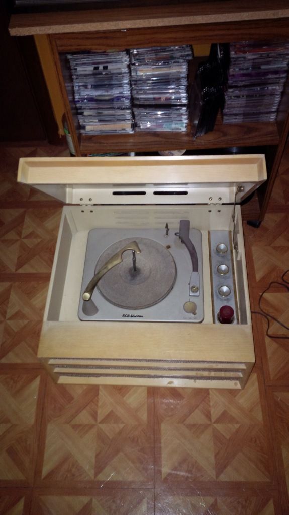

Just found a RCA 6-HF-5 record player at a flea market. I have recapped the amplifier and Added tubes since when I got it home there were no tubes. But not bad for twenty dollars. Heres my problem, when playing 45's the arm does not reach the first groove of the record. How do I adjust this . Does anyone know the SAMs number for the photofact for the turntable section. Thanks for any help. By the way this is the blonde model. Oops should have mentioned that the 33/speed is slow, how do I correct this.Image

There is a slot at the back left of the tonearm, looking at the player from the front. Inside that slot is an adjusting screw. Use a smaller flat screwdriver to adjust needle set-down position--counterclockwise to move the set down further into the record.

Thanks for the help so quickly, and for some reason the lp speed has corrected itself.

Do I have to lift the turntable up to find this adjustment screw?

No, the screw is in the back of the tonearm inside that slot. Shine a flashlight in there...you'll see it.

I cannot locate a slot in the back of the tonearm. Here are a few pictures of the back of the tone arm.ImageImageImage

I have circled where the slot is. You will have to move the tonearm wire temporarily away from the slot to make the adjustment.

You are the man, adjustment made and success achieved . Thank you .

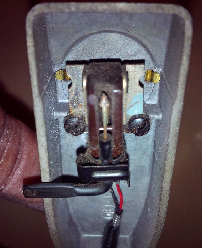

What stylus is the best for this phonograph ? Suggestions and why you use this type. Thanks in advance.

Hello,
Regarding what type of stylus to use:
Can you shoot a photo of the cartridge ? From the photo yours has a flip-over plug-in cart. It is an all in one ceramic cartridge with permanently mounted styli.
The schematic indicates using a Pfanstiehl 55-T (Electro-voice 47). These are mono cartridges with a
1 mil stylus, which you cannot play on stereo records.
If you want to play stereo records, you will have to change out this cartridge with a stereo one.
Then you can wire both L/R leads with a jumper wire so both channels come out of your mono amplifier.
Gary at http://www.thevoiceofmusic.com can recommend a ceramic stereo cartridge that includes the jumper and wiring instructions. He will also have the mono carts, also.

This is The best picture I could get of my cartridge hope you can identify it.Image
