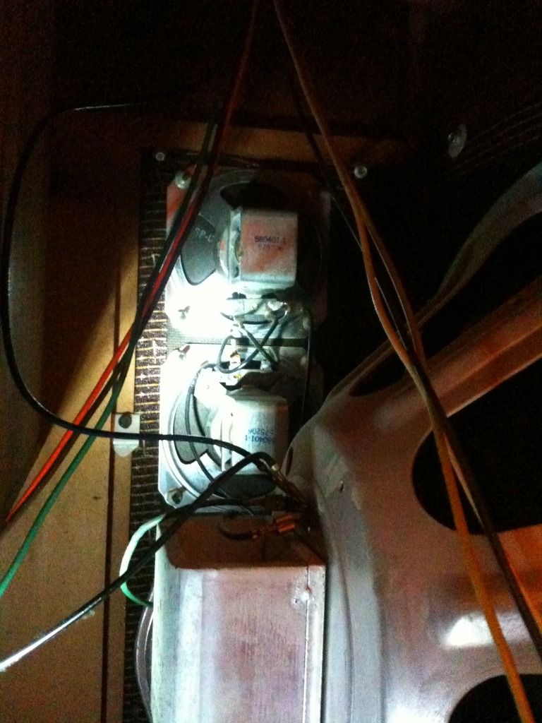

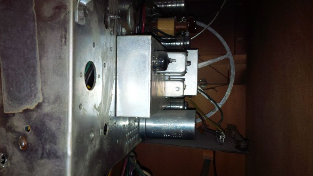

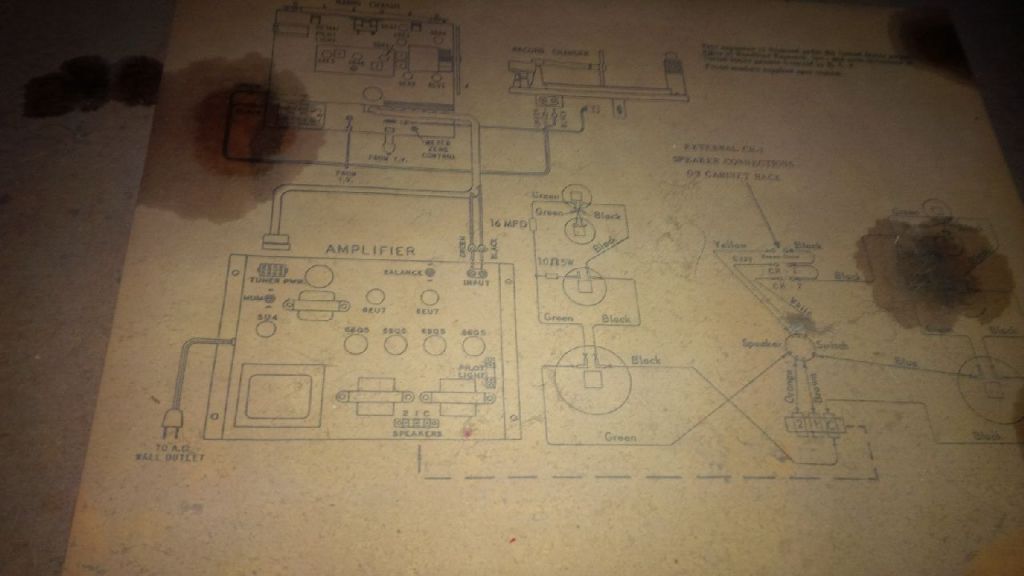

New pictures of the interior of the console plus what numbers I could find on the chassis and tuner. I think the chassis is still a mystery .Image the numbers I could locate are 57-16-00, 1888201, and ko-597-b. hopefully someone can make sence of all this.ImageImage more to come.

First off edit this thing to bring it into alignment.
Revisit your model number. It's not right but I want
to know. And dust off the amp number.
I think you will find it is 93- something.
The tuner chassis number of 57-16-00 is good. That's covered
in SAMS 623-10.
The K0 597B is your multiplex. Look for another number
with 70-something. An extra there and it's a winner. It's covered
by SAMS 654-10. Once you get back on amp number I'll get some SAMS
posted. What a good set.

I'm going to post SAMS now. I'll do the two SAMS for 93-AMPS.
Still like the correct model number for x-ref purposes.
SAMS 586-8 for your amplifier.
https://app.box.com/s/z87awqdg3empgrtcnx8e
SAMS 623-11 for your amplifier.
https://app.box.com/s/4slqu40qfljeieum7wik
SAMS 623-10 for your tuner.
https://app.box.com/s/41xzpypk6hhfvzakn7ug
SAMS 654-10 for your multiplex.
https://app.box.com/s/aio7amgl2jblyk4k4bg4
I sometimes place notes on my SAMS. A little messy. But I call your attention
to SAMS 586-8 for clarification. There's an error by SAMS
in the title. SAMS 586-8 is for the 93-03-00 and 93-04-00 NOT 93-01-00
and 93-02-00 as shown. Now how correct either SAMS bears out in actual
equipment is no problem. The amplifier is simple to work on.

The two 16 mfd non polorized cap, what is the voltage rating on them , I can't seem to find that info on the schematic .

The schematic calls for 25v nonpolarized for C2 and C3, but a good replacement would be Part # 027-344 from Parts Express, which is rated at 100v.
These are the crossover caps.
