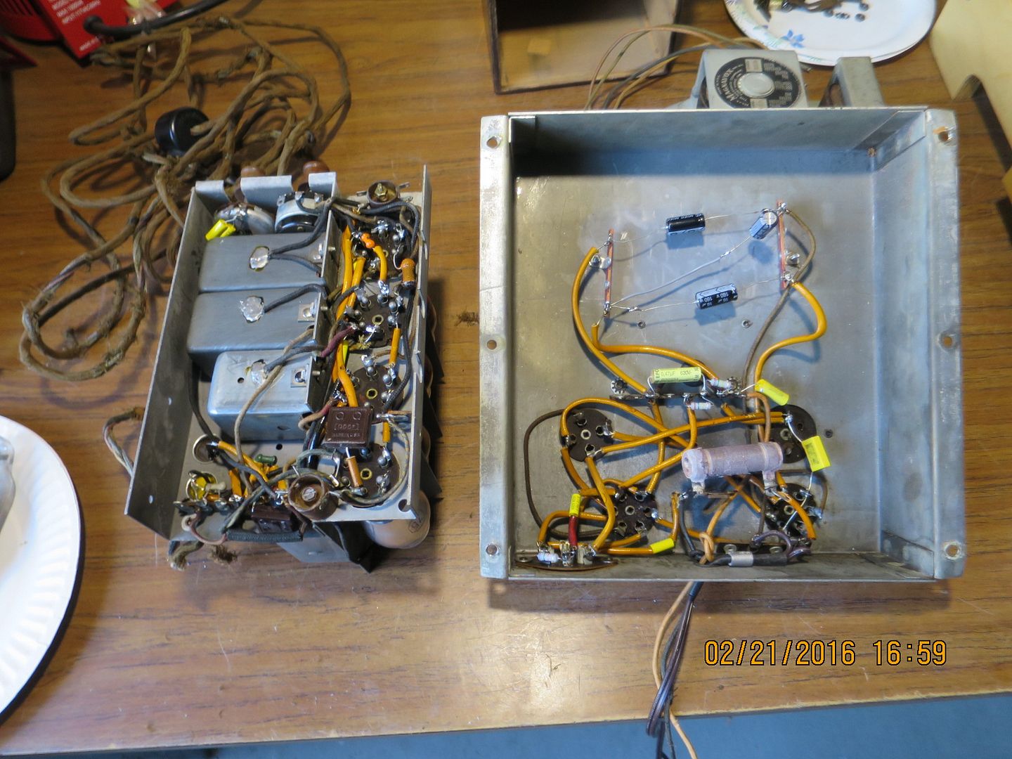

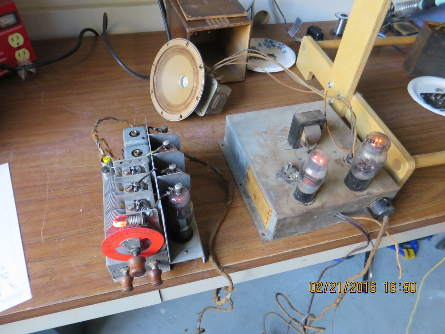

This showed-up at the SCARS auction yesterday. It has a small remote at the end of an approximately 18 foot long cable, and a tombstone cabinet (perhaps with a missing floor stand). As far as i can tell, the images which follow are the only ones of this model on the Internet (and I will put them on Radiomuseum). Page 564 of the March, 1934 issue of Radio News mentions that this model has recently been announced (along with the fancier Model S-10). That issues also has an interesting article on the 500,000 watt WLW transmitter. Pages 166 - 167 of the August 1934 Issue of Radio News have a feature article on the S-10 version of this radio. Radios News is on American Radio History:

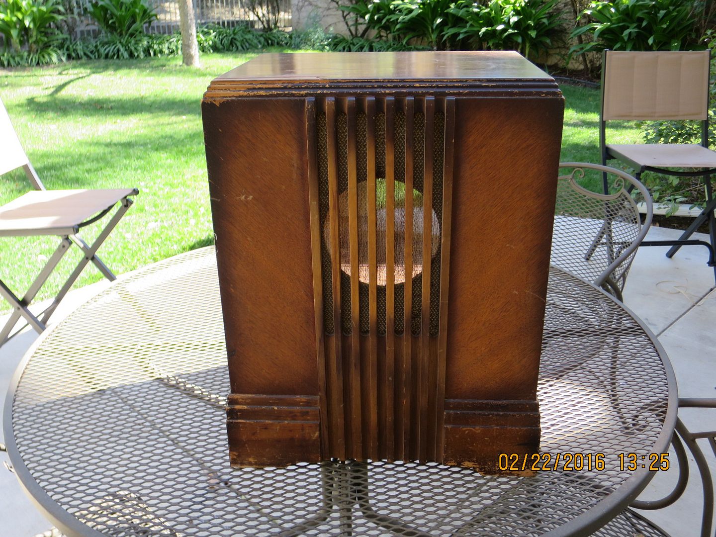

As found. Note the darker toned lacquer is over-sprayed, an effect I will try to duplicate when refinishing the cabinet.

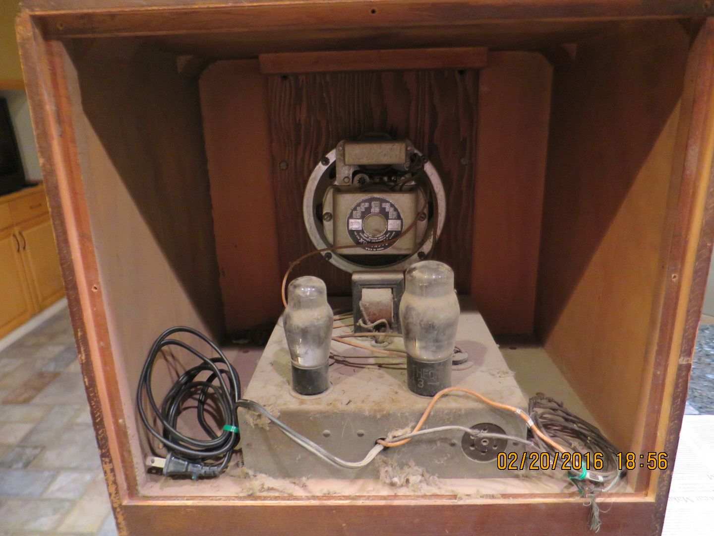

The speaker and power supply cabinet with the wood back removed, as found.

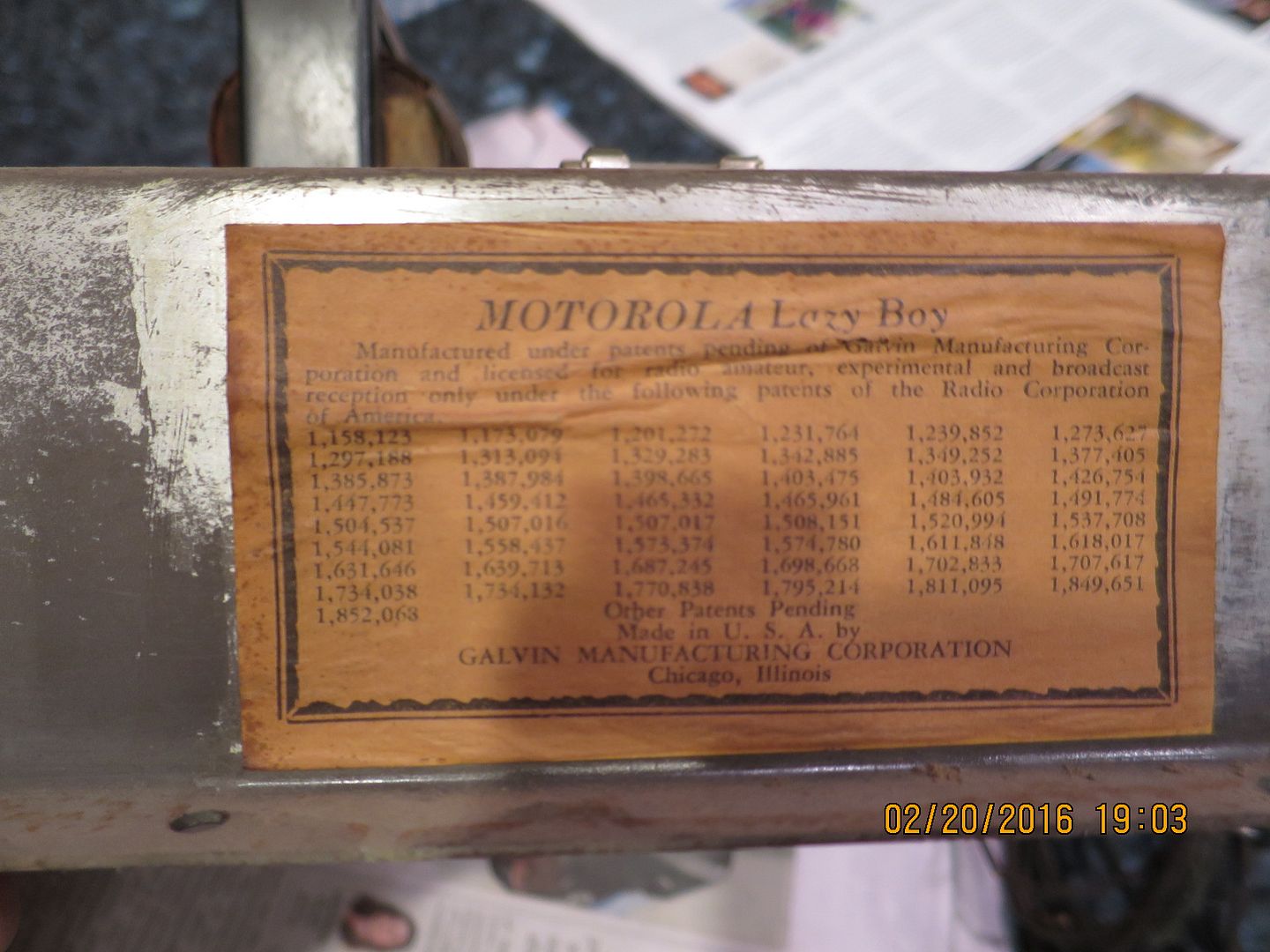

The chassis label

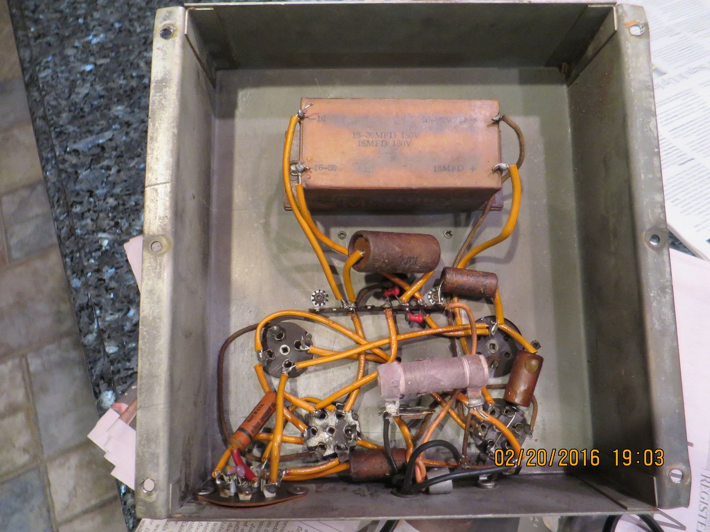

The bottom of the power supply and final audio chassis as found

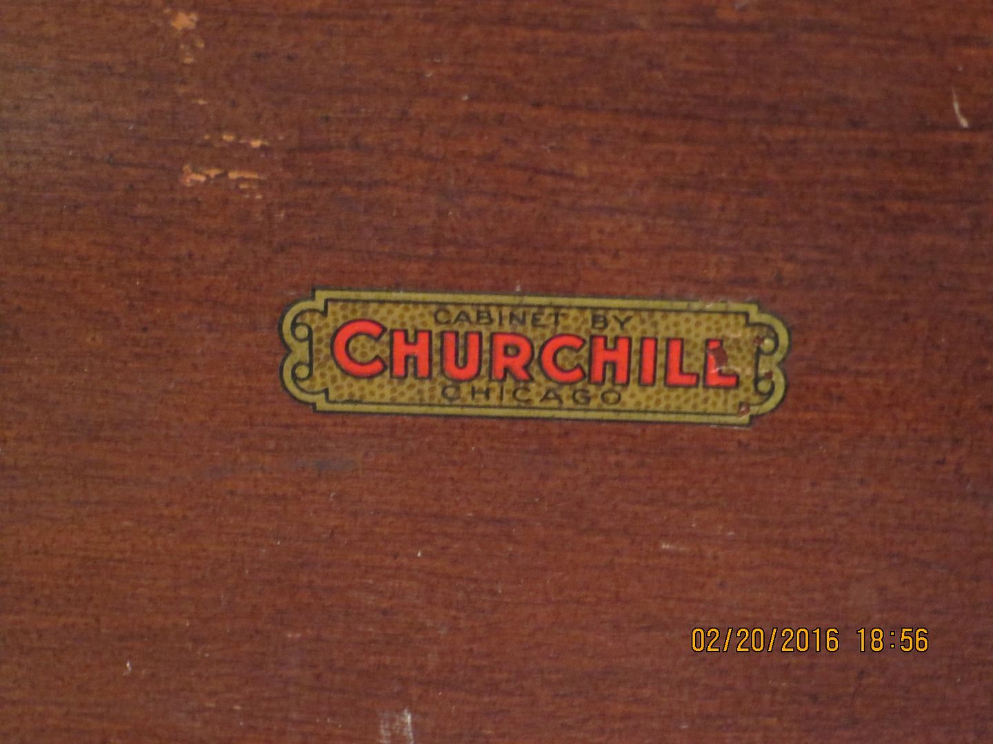

The cabinet maker's label

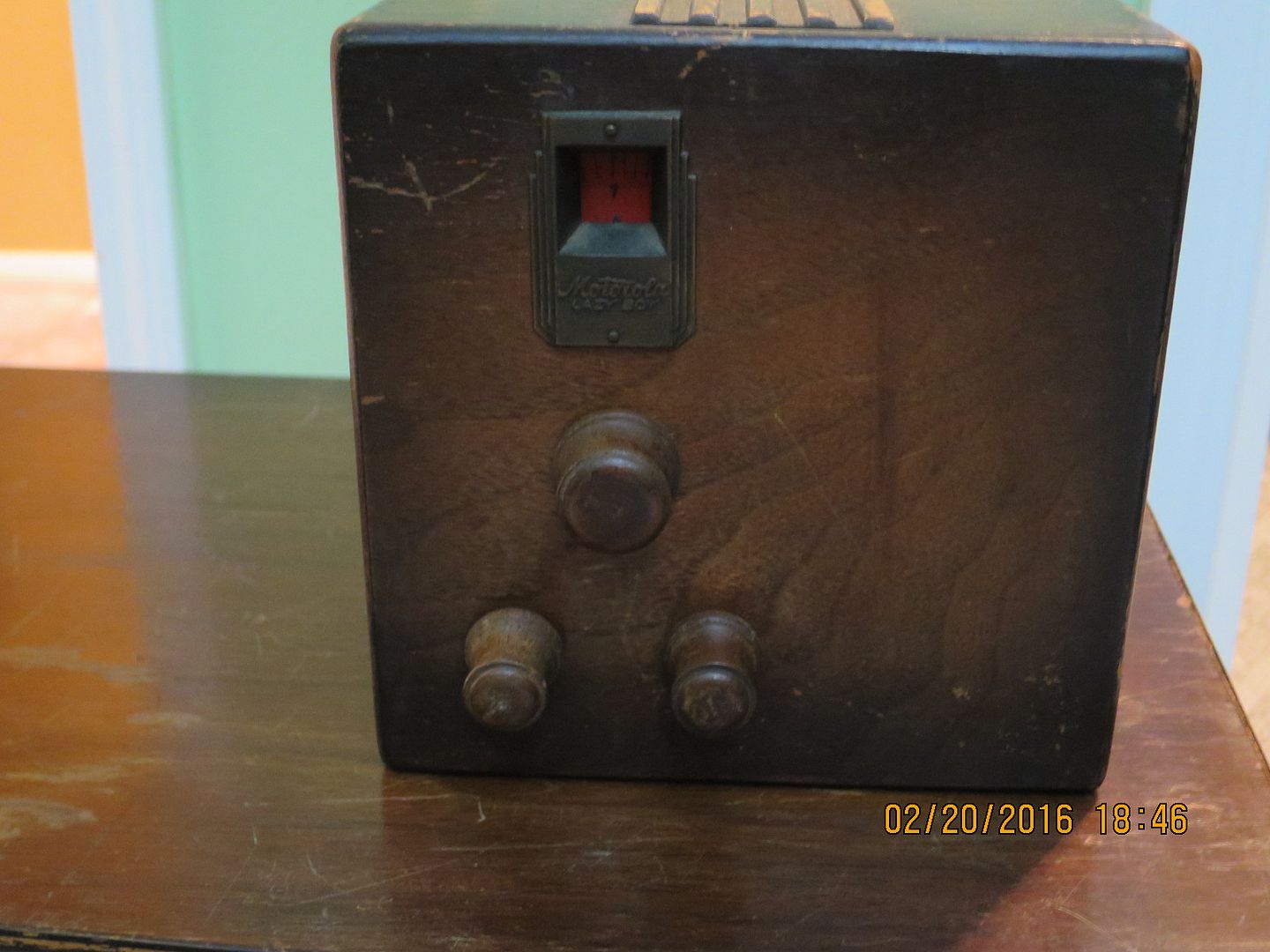

Closeup of the remote, as found

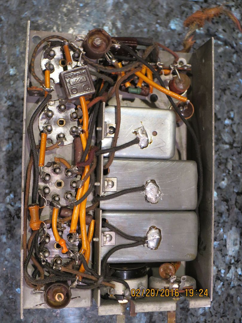

The remote chassis as found
The bottom of the remote chassis as found
A 0.01 capacitor which was hidden in a coil can
The radio playing on my work table
The bottoms of the chassis after the electronic refurbishment work

The remote is so tightly built, I wonder if it was related to a Motorola car radio chassis?
From the schematic, it looks like it would be easy to build the base chassis and put it in a spare cabinet, if you have the remote.

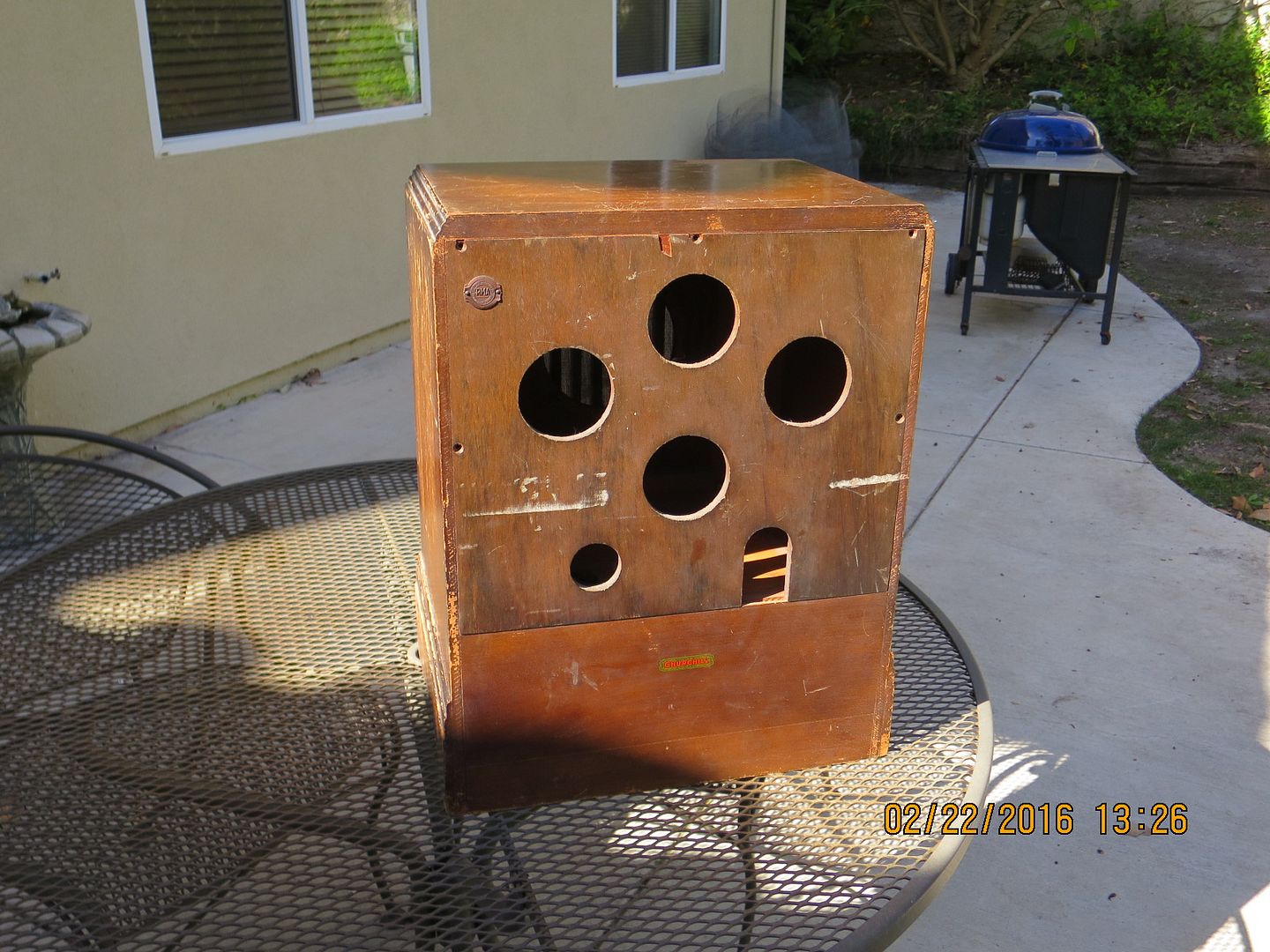

The speaker and power supply cabinet outdoors to show the toned lacquer over-spray shading
The back of the speaker and power supply cabinet

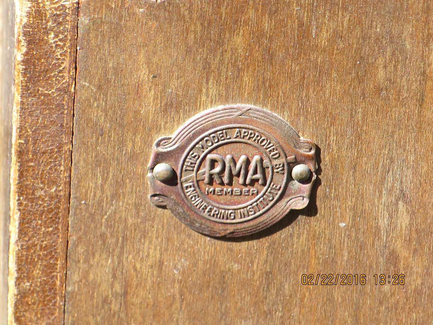

The RMA medallion

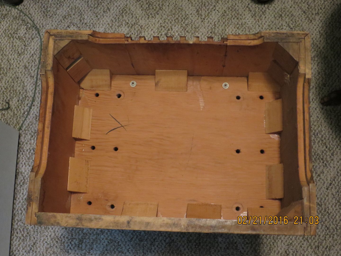

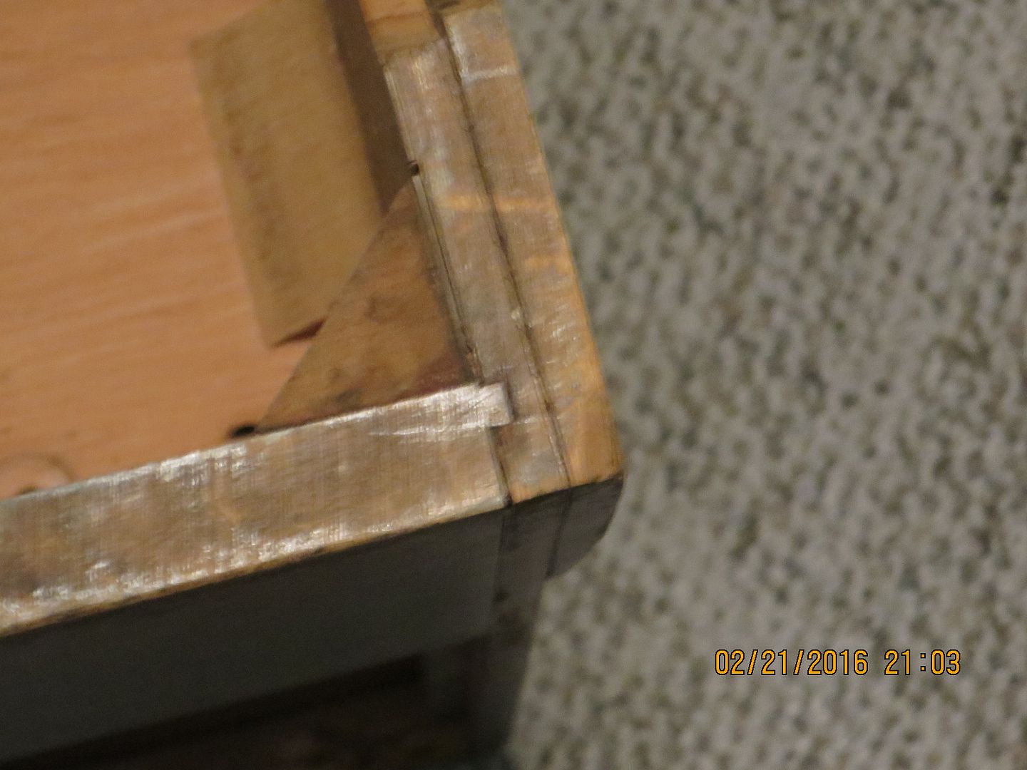

The bottom of the speaker and power supply cabinet
Detail of the bottom of the speaker and power supply cabinet, with no signs of any holes for feet of any sort, strongly suggesting that it sat on the base shown in the photos of the S-10 version

The audio only goes one way - from the remote to the chassis containing the speaker, power supply, and audio output tube.

Thanks, Dave, for posting that schematic. I probably should have put it in the original post. I have played it and it seems to work fine, but I need to do more experimenting. Since I've got the chassis finished, except for polishing and alignment, I guess I need to move the cabinet up in priority and get it done. The weather is nice today, so I'll probably strip it.
