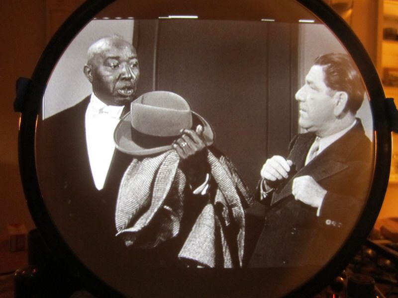

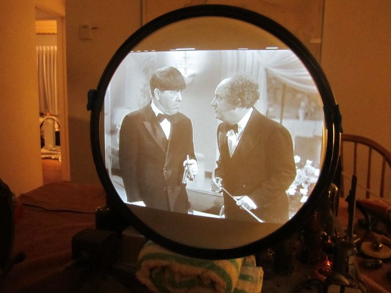

Did a bit of troubleshooting of the Video stages. Replaced a couple of suspect 270pF micas and V103 and V104.
Not bad. Not quite 630TS territory, but quite watchable. Sound is good.
