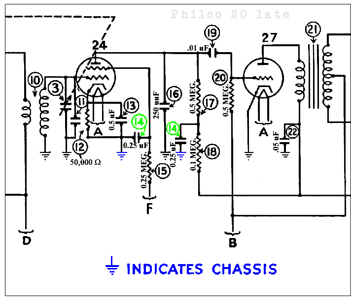

Wondering how to replace metal can no 14 it is a .25 two section so does that mean the two wires are a .25 lead each and the other side of each cap goes to chassis ground thanks.

 Post subject: Re: Philco 20 baby grand
PostPosted: Sep Fri 01, 2017 1:04 pm
Posts: 28912
Location: Annapolis, MD
What does the schematic show?
The most common construction of these cans is to have the ground connection made internally....then the connection to chassis is made when it is mounted. Sometimes a "ground" wire is brought out. Regardless, you have to make it functionally match the schematic.
-Mark

PostPosted: Sep Fri 01, 2017 2:07 pm
Posts: 13937
Yes, part 14 (3557) is two paper .25μF capacitors.
The original manufacturer's test voltage for this metal case capacitor was 1200V
Use 600/630 Volt here and elsewhere in your radio.
You can connect two leads to the metal case if you wish, the other two as shown in the schematic above. use heat-shrink tubing (Spaghetti).

spsquires wrote:
If I was sure of what the schematic showed I would not of needed to ask this question.
I think it would help you to tell us what you are looking at..and what exactly is confusing. I see item 14 in two places on the schematic---- both with one end going to chassis ground.
As an aside, this might illustrate why it's a good idea to restuff these things. The circuit could depend on the AC currents in those caps going to the same point.
-Mark
