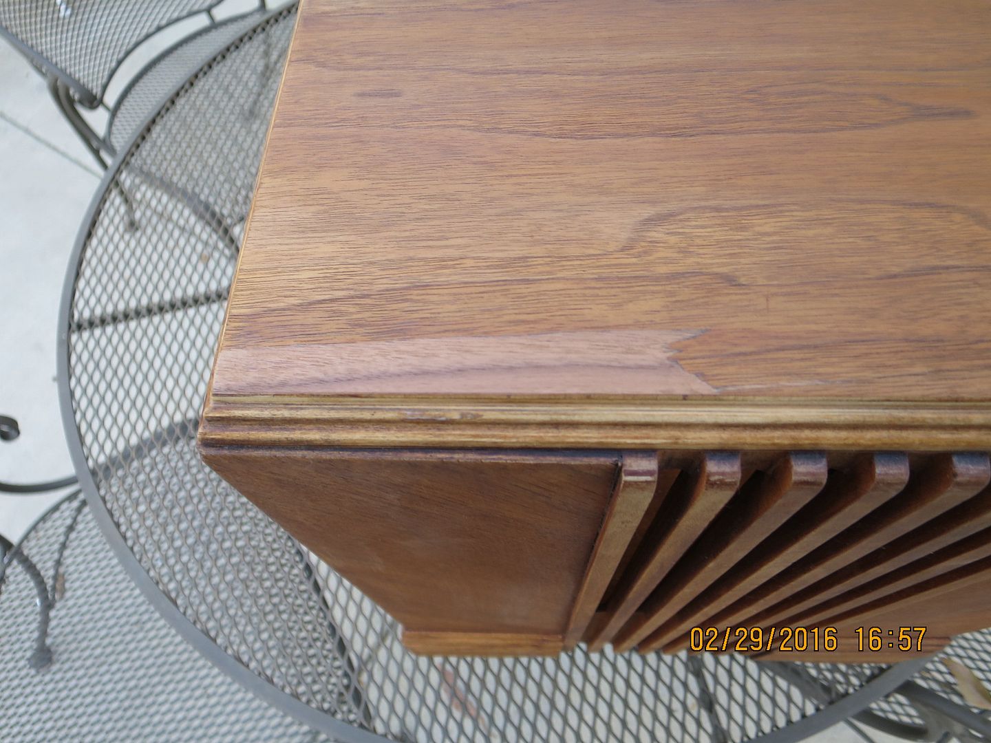

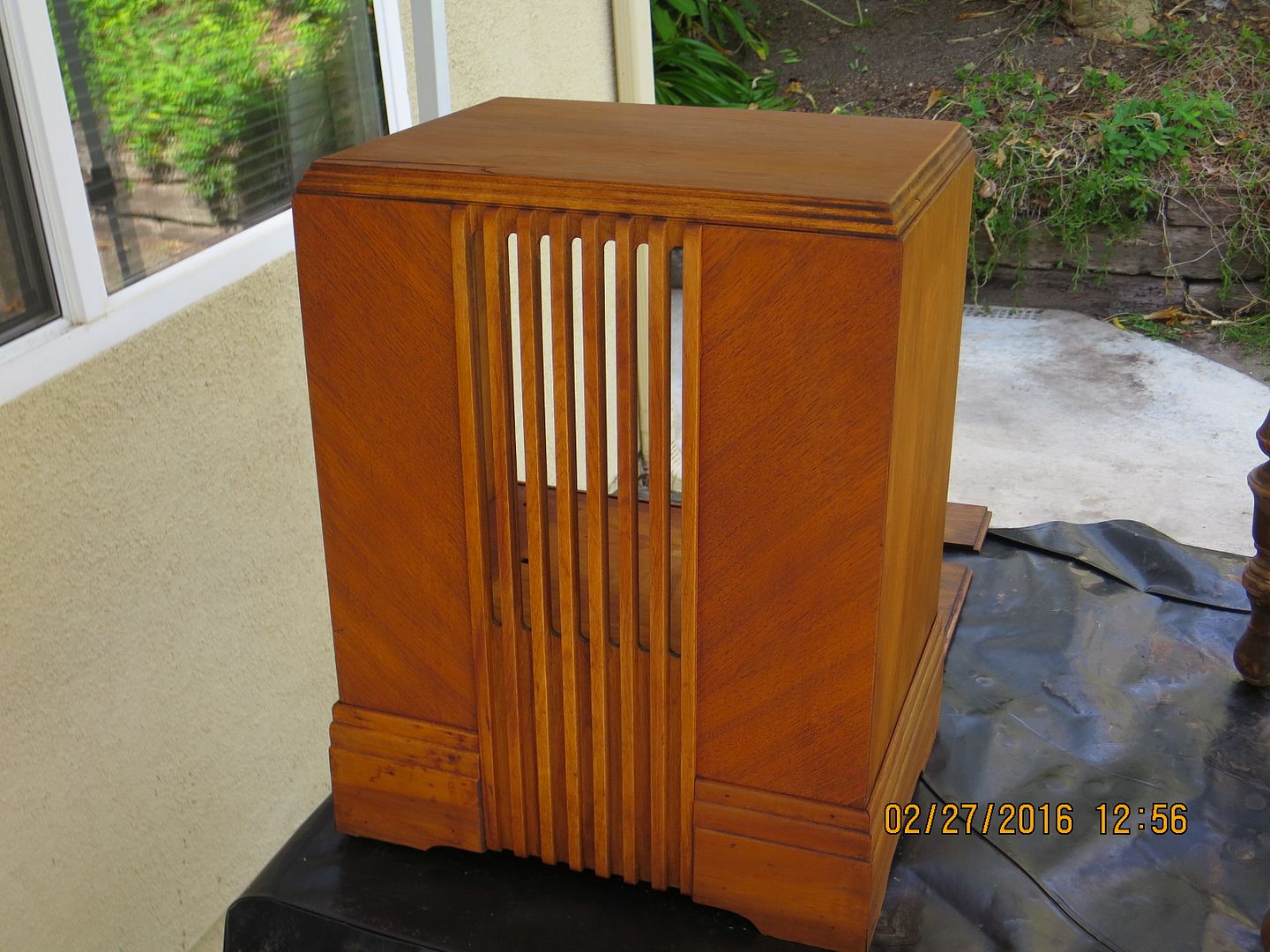

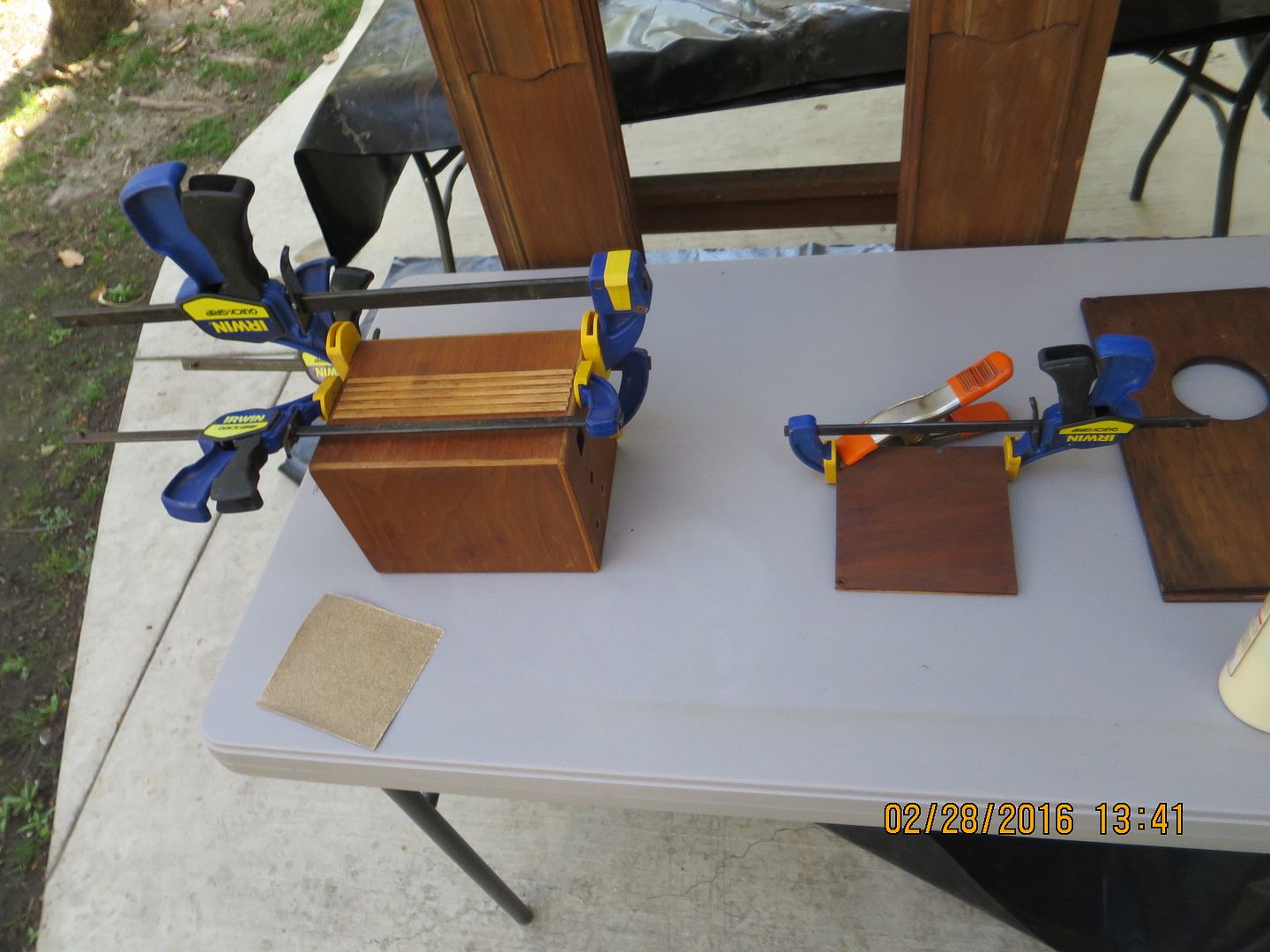

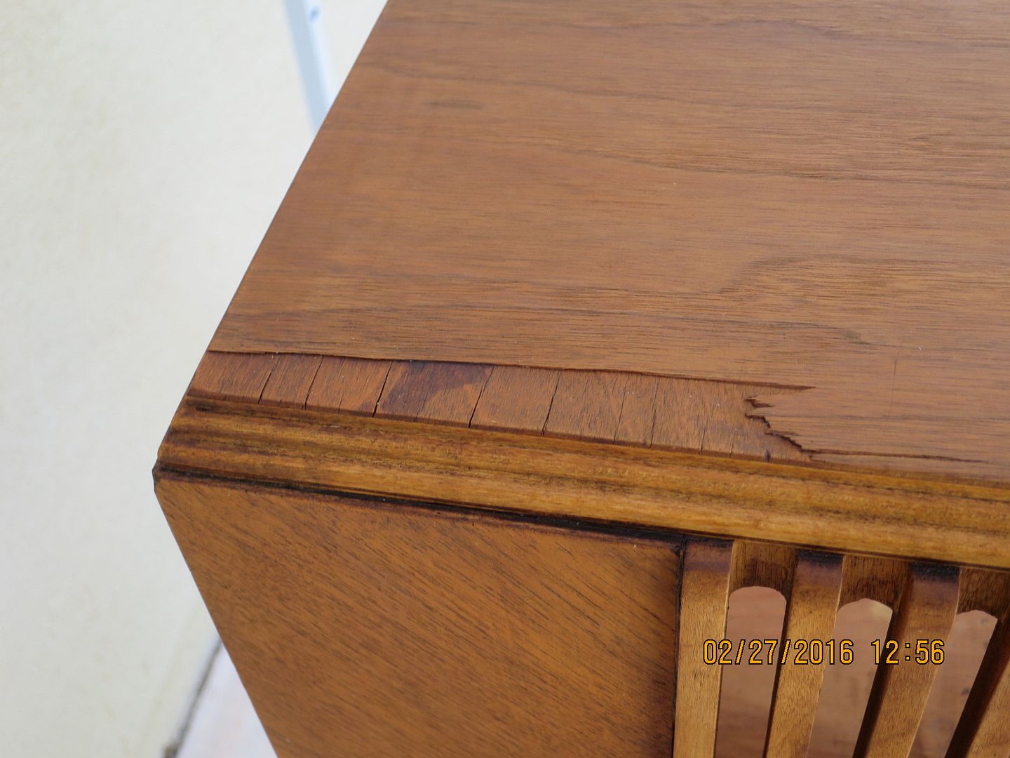

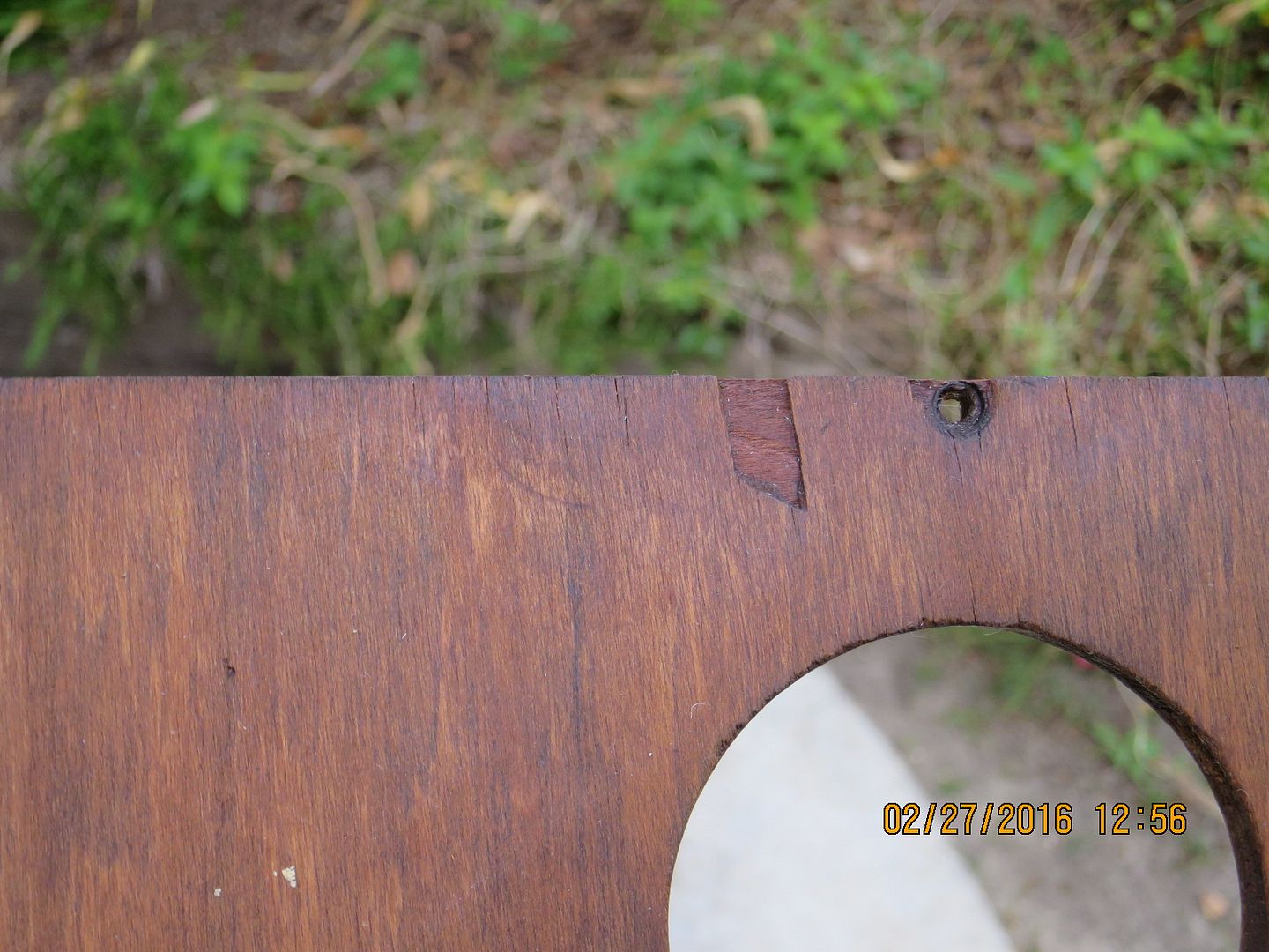

The cabinet is stripped,mainly with acetone and some lacquer thinner.
I will repair this by overlapping a slightly over-sized piece of new veneer with matching grain, using yellow wood glue, and clamping tightly (using a block of wood and wax paper). I will then sand down the parts of the repair piece which overlap the existing veneer. I used Mohawk wood epoxy, walnut color, on the cracks, and have the loose substrate veneer layers glued and clamped.
Likewise for this chip on the back

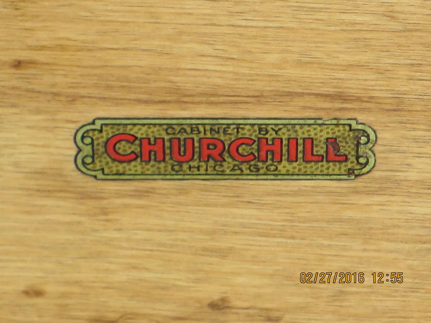

I took care to save the cabinetmaker's decal, cleaning around it with a rag and cotton swabs

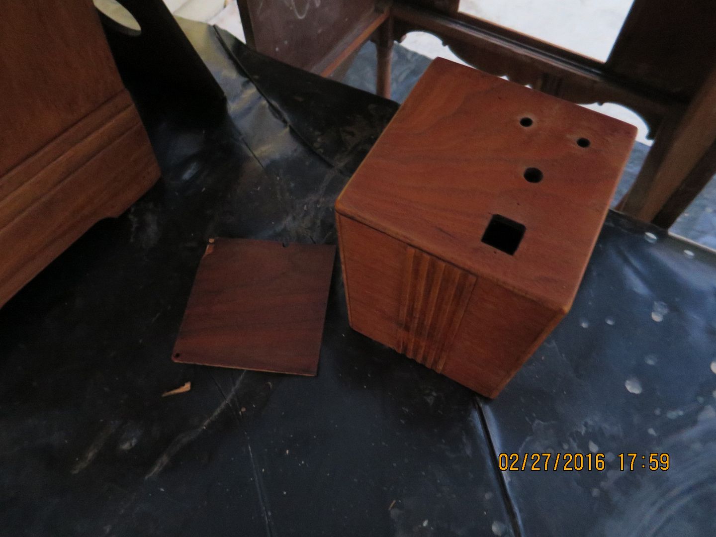

The remote stripped, with a corner chip in the back which will be repaired

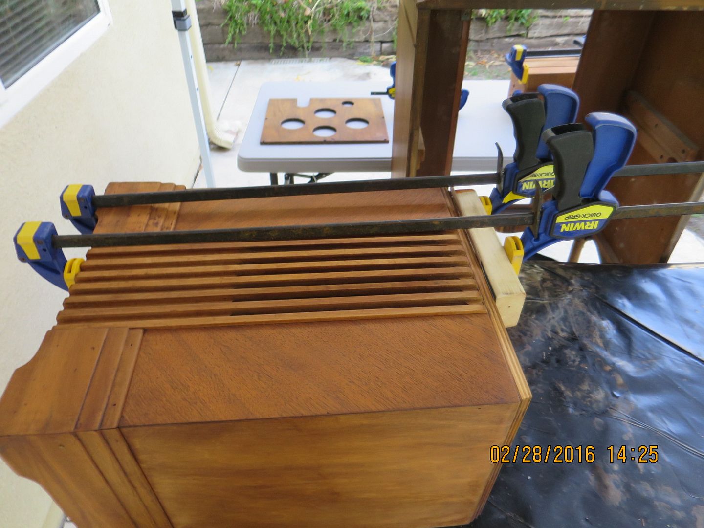

Glue repairs to the remote control cabinet underway:
The over-sized veneer repair piece clamped to the top of the speaker and power supply cabinet , with weather strip foam under the piece of 2x3:
The veneer repair on the top of the speaker and power supply cabinet (note the thin strip of new veneer where a thin strip was missing on the right side). I'm not sure I like the repair piece now, as it seems to need more grain. I may wipe on some stain to evaluate it.

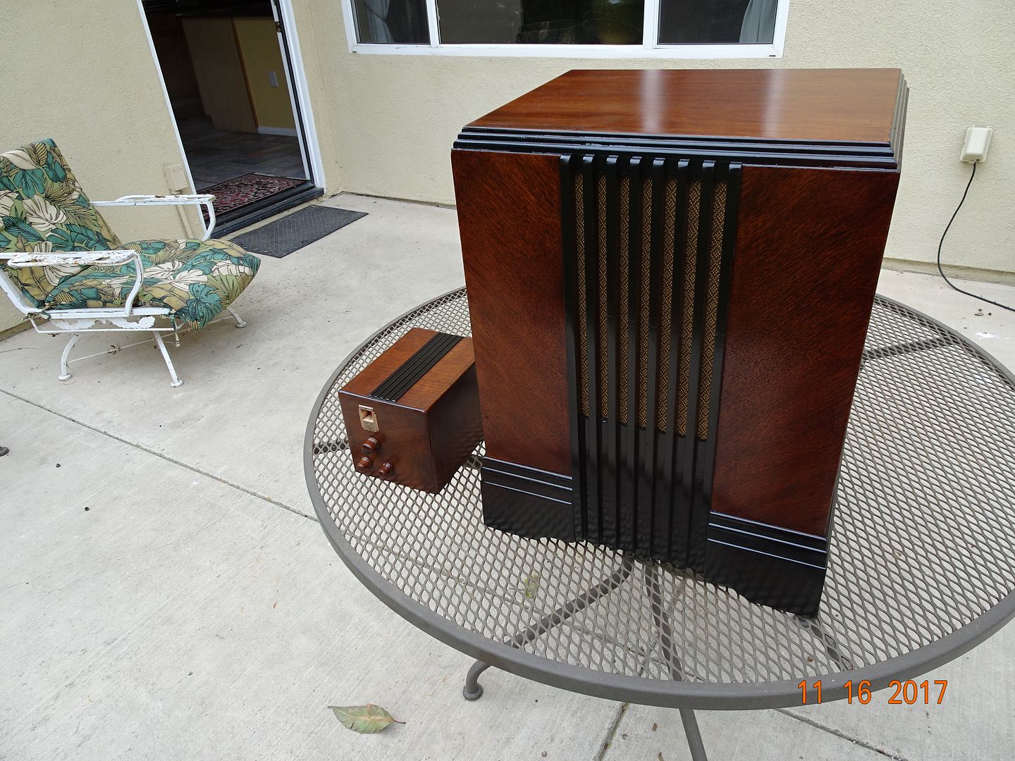

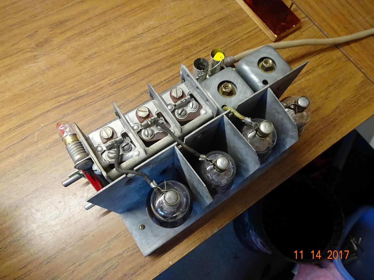

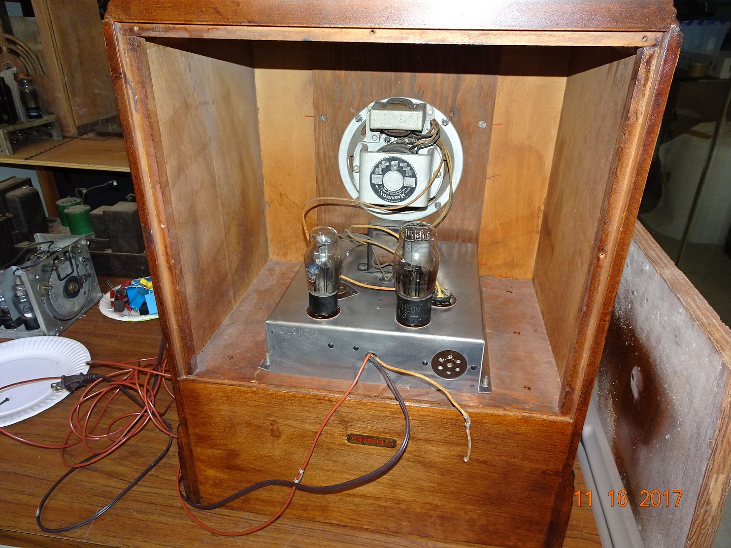

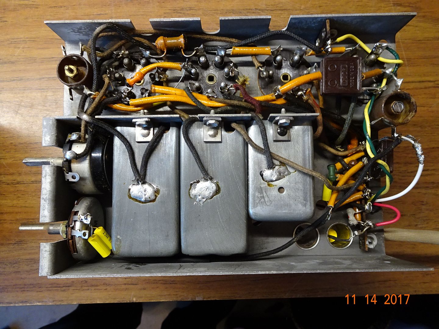

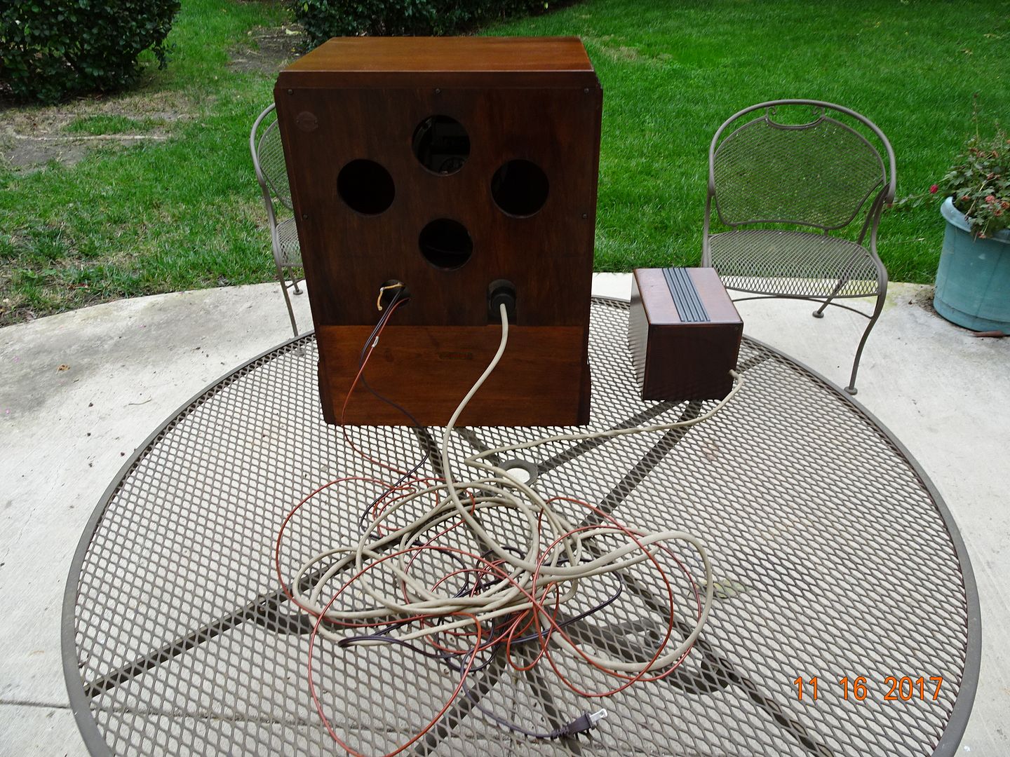

It is finished, looking good and playing nicely.
After studying photos of the bottom of an S-10 base unit, I realized that the J-8 never had the same legs. I would have seen glue residue and so forth. I did find some holes in the J-8 base which were probably the tack feet originally installed.
Have you ever seen one? I see that one of the remote units (only) sold on Radio Attic, but can find nothing on the Internet to indicate than any others have survived. In 1933, Motorola decided to see if they could be successful selling home radios, so came out with the J-8 and S-10. The brief articles on them in the old radio magazines only show the S-10.
Making a new cable to connect the remote to the base unit was not easy. I found some fiberglass sleeving which is a nice color, then make the cable from individual wires. One wire is shielded. Pulling them through the sleeving was difficult.
